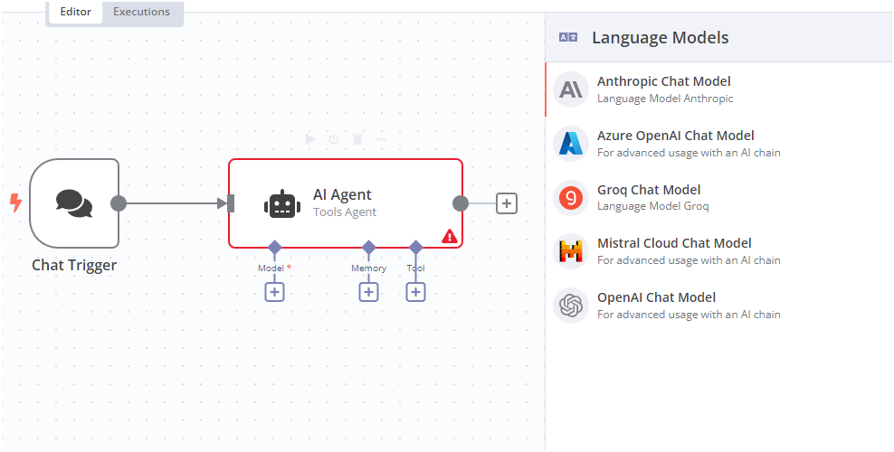

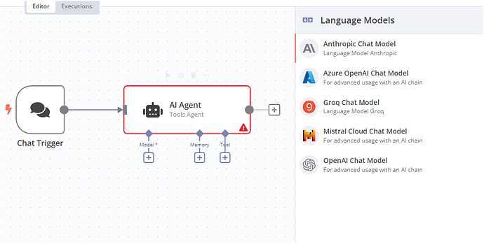

The latest Google Gemini models (1.5) do support function calling as documented here Intro to Function Calling with Gemini API  |  Google for Developers but are not available options for the AI Agent node.
At time of writing, I’ve found Google Gemini 1.5 flash to be 10x cheaper than GPT-4o but just as good. For example, a job running GPT-4o which costs $1 I found to cost $0.10 in Gemini - for a batch of 500 jobs, this is the difference between $500 vs $50.
This could be a key consideration in productionising AI workflows.
Missing option in “Model” subnode options for AI agent.

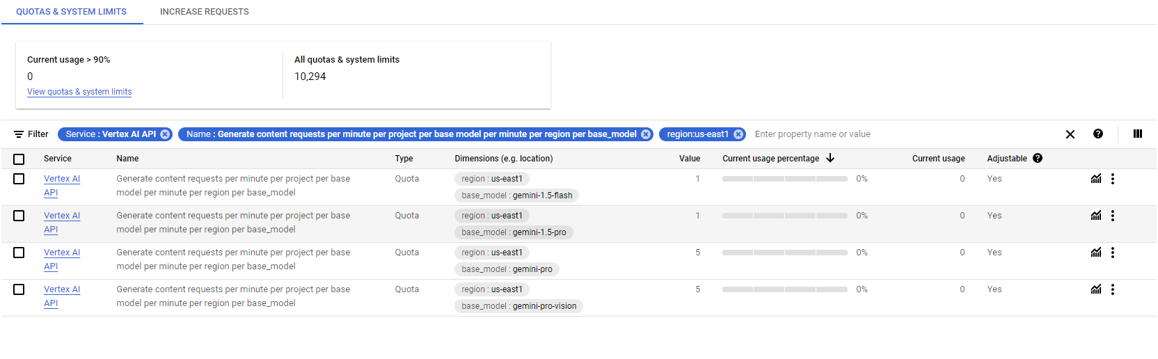

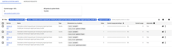

2. I hit the default quota Limits very quickly with Agent Tools.
Unfortunately, my excitement quickly died about 10mins after switching some of my workflows over to use Gemini via this node. Is it me or are the defaults are set very low?
I’m told my billing profile doesn’t qualify for a quota limit increase though so I’m kinda stuck I guess :woman_shrugging:
Will revisit in the next few weeks. If anyone else can give advice, that would be greatly appreciated!
