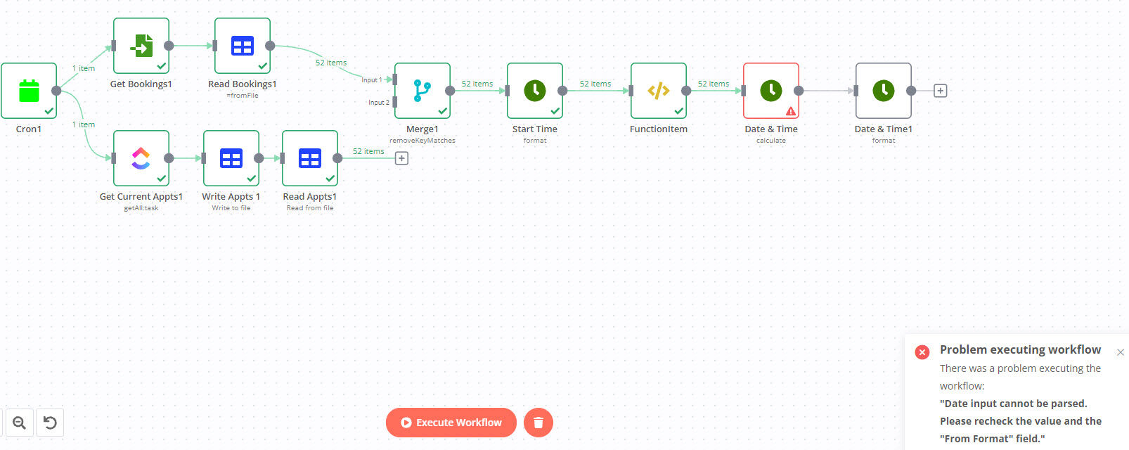

Thanks @BramKn that works, the only issue I’m still having is after changing the item.myNewField to $json[“startTime”]; to pull the unique time for each item the datetime node is unable to parse the date correctly even though its still in the same format? Tried also change the from format value with no success.
Hi @SteveMcc
You do not need the function item node. This was just for me to get a value I could reference in the date&time node.
Have you tried just using the startTime field as the source for the date&time node? If this doesn’t work please show your workflow, so we can see what is going wrong.
@BramKn Yes did also try using the startTime as the source and doesn’t seem to be able to parse it properly despite being the same?
Hi @SteveMcc
Sorry for the late reply.
The error shown gives you the issue quite clearly. The from format you set isn’t correct. Usually you do not use the from format unless it is not working. In this case it was not working because you had the wrong value selected. You use Starttime as a value, which is no value.
You needed to use: {{$json[“Start Date”]}}
Below is the JSON for the 2 Date & Time nodes to add the time and reformat the time. You can copy paste the JSON into n8n and connect it to your flow. I have changed the input to the correct field.
