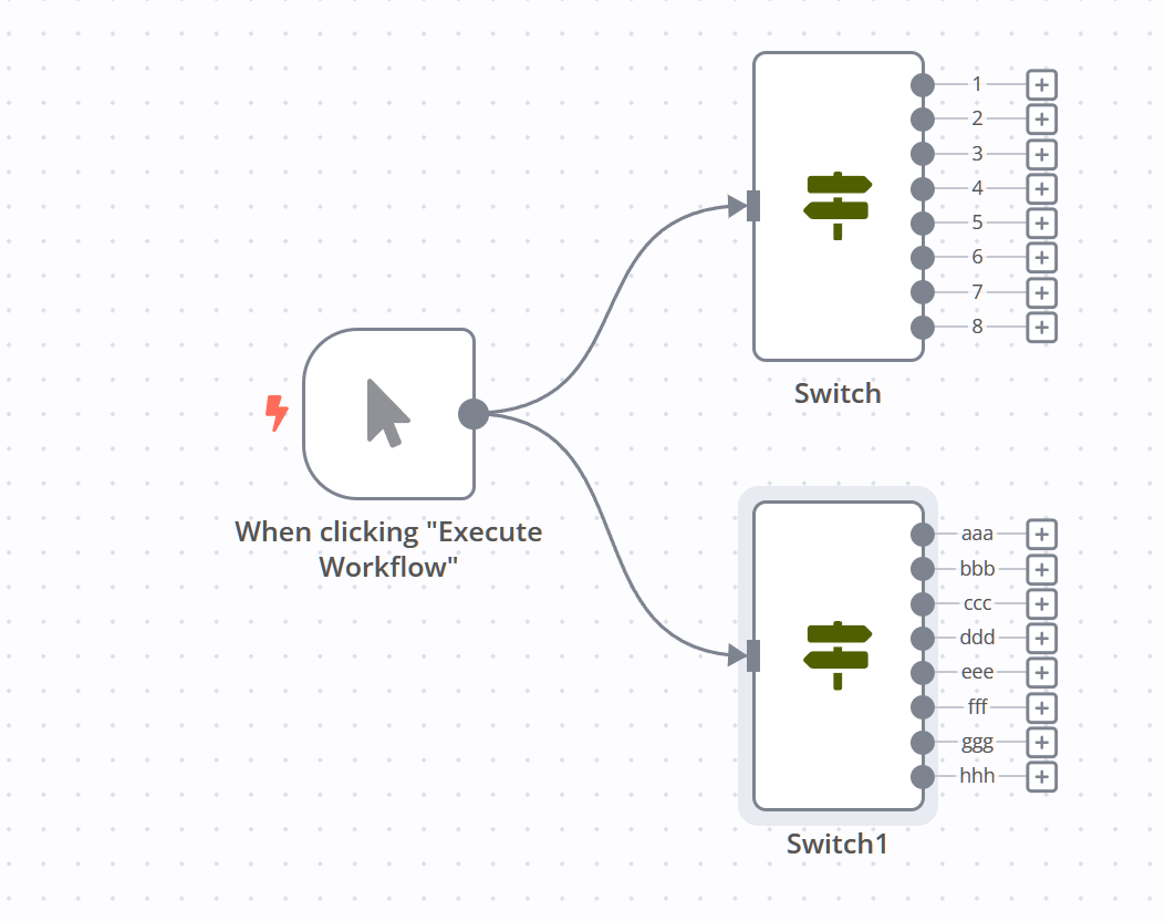

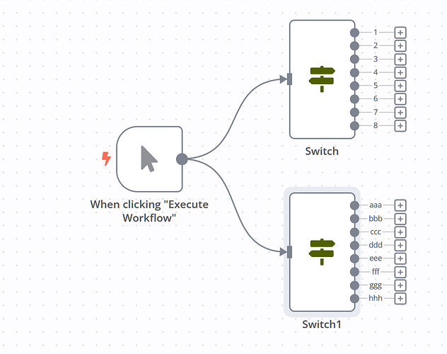

Hey everyone. I’m coming with good news to say that we will finally release a switch node with infinite outputs soon. We’re expecting to clean it up next week and then release it pretty soon :partying_face:
New version [email protected] got released which includes the GitHub PR 7499.
amazing!
well done team!
Love it, now I can deprecate the Switch9000 :slight_smile:
I got up to 136 before I got bored of adding them :joy:
hahaha, 8 was enough for me to test :laughing:

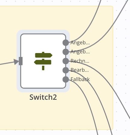

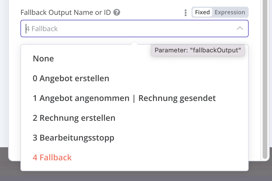

Hi, two notes from my side:
  1. When specifying the fallback output, I must select one of the previously created routes, but not necessarily my fallback is one of them. Wouldn’t it be better to also have in the dropdown something like “Other” and then I can manually connect this fallback output in the editor with whatever I want?
    (in my example I had to create an extra route rule, that I called Fallback and then select it below in Fallback output)
  1. I find the chance of giving labels to each route great. However, the text gets abbreviated too short, it doesn’t visualize more than 5 characters… Can we have a bit more space for it?
