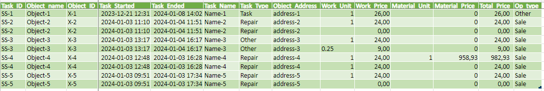

I am trying load data from Excel, do some adding up and send it to other people.
Here is example input
Same data below but in JSON

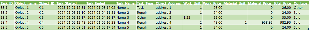

Here is desired output.
Basically what I am trying to do is merge data based on field Task_ID

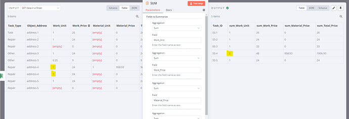

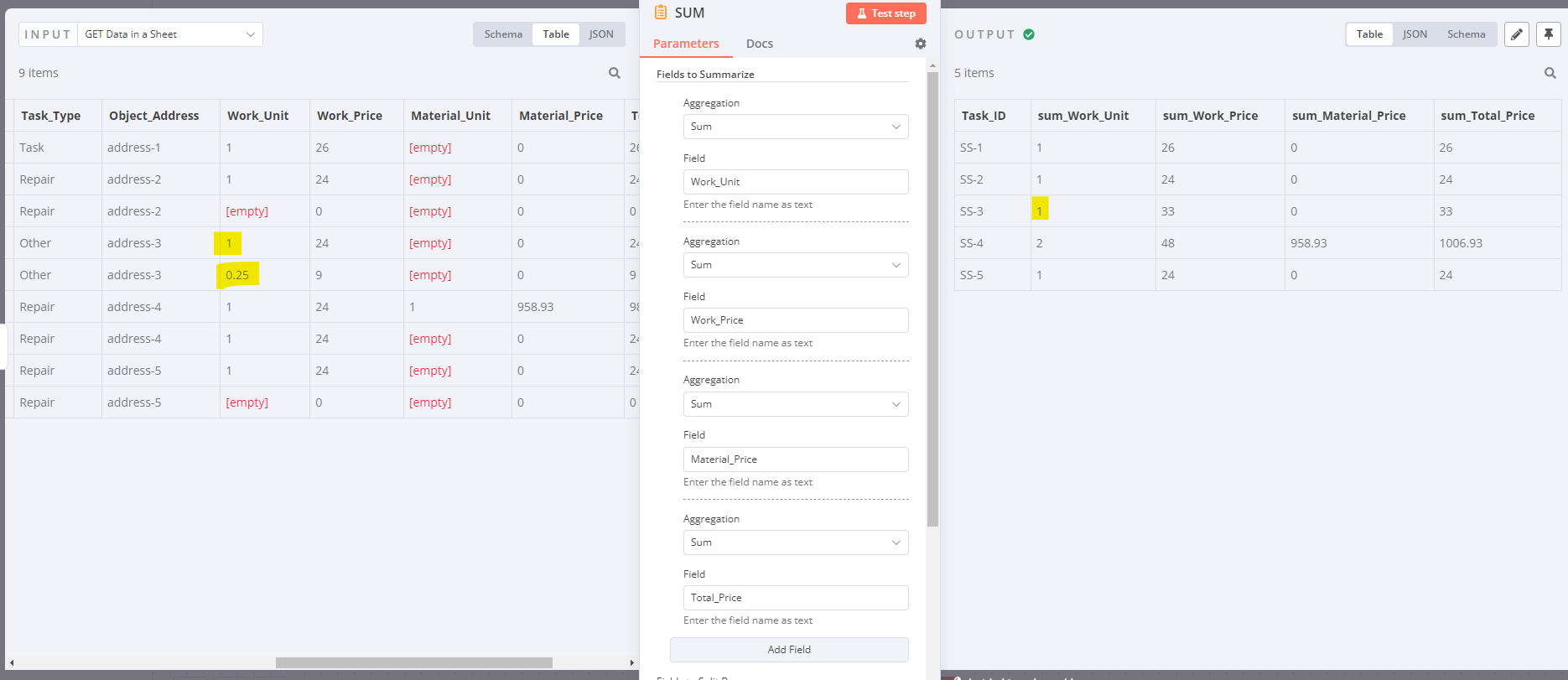

Where I am stuck is I don’t understand why Summarize note is not adding up 1 and 0.25. It returns 1 as a result where it should be 1.25
I can see it sums up 1+1 correctly so there is something going on with float numbers I guess.

hello @Tom_M
That’s because the field Work_Unit may be a string or a number
Here is the fix
