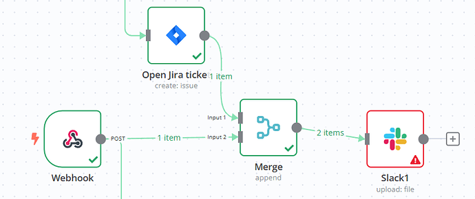

After a Merge node, binary file is not found even though it's in the input
After a Merge node, binary file is not found even though it’s in the input.
This operation expects the node’s input data to contain a binary file ‘FileUpload0’, but none was found [item 0]
Make sure that the previous node outputs a binary file
I have a Webhook node that contains a binary file. After merging it with a Jira node, the merged data is sent to a Slack node for file upload. The binary file is shown in the input of the Slack node but when uploading it, it says binary file not found.
If I remove the Merge node and connect the Webhook to Slack directly, the upload works correctly.
I’m confused as to why it errors after merging. Any help is much appreciated.

I believe you use “Append” mode in Merge. As a result the output has 2 seperate items - one from Jira and one from Webhook. When Slack tries to use data from the 1st item there is no binary file there as it is in the 2nd item.
I suspect you need to use “Combine” mode in Merge so that output contains only 1 item, which will consist of data from both - Jira and Webhook.
That’s it! Thank you for the solution!
