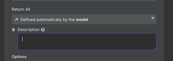

I would suggest to make sure that:
  1. Your nodes are named correctly. The node name is the tool name and can help AI distinguish the tools.
  2. Your tools have a clear description.
  3. Your parameters have a description.
If all of these are set, the LLM should have no trouble calling the right tool.

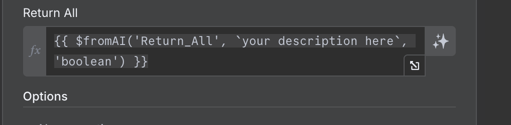

Here is the workflow with a simple example with user supabase tool.
I just added an ai defined parameter with a description for ‘firstname’ and it doesn’t even use that correctly. Am I missing something ?
