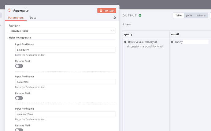

Aggregating data without outputting as arrays
I am using the Aggregate node to combine the output of two other nodes.
I’m able to structure the data how I want it, except that every piece of data seems to have been added to an array.
So rather than outputting:
query: “string here”
it’s outputting:
query: [“string here”]
See here how the data in the output is all after “0:” in each field.
How do I remove that and get it to output the data in the same way it is formatted initially? I.e. if it’s an array, then it outputs as an array, but if it’s a string, it outputs as a string, rather than a string inside an array.
