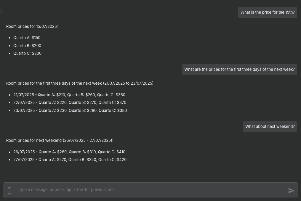

Hey @Ferrgabe hope all is well, welcome to the community.
I would like to propose you use the sheet tool and let AI Agent figure out the rest, for example:
Our chat:
ME:
What is the price for the 15th?
AI:
Room prices for 15/07/2025:
Quarto A: $150
Quarto B: $200
Quarto C: $300
ME:
What are the prices for the first three days of the next week?
AI:
Room prices for the first three days of the next week (21/07/2025 to 23/07/2025):
21/07/2025 - Quarto A: $210, Quarto B: $260, Quarto C: $360
22/07/2025 - Quarto A: $220, Quarto B: $270, Quarto C: $370
23/07/2025 - Quarto A: $230, Quarto B: $280, Quarto C: $380
ME:
What about next weekend?
AI:
Room prices for next weekend (26/07/2025 - 27/07/2025):
26/07/2025 - Quarto A: $260, Quarto B: $310, Quarto C: $410
27/07/2025 - Quarto A: $270, Quarto B: $320, Quarto C: $420
Chat photo
Hey @jabbson!
It worked, i didn’t know there was a Google Sheets Tool.
Thanks for your help!
