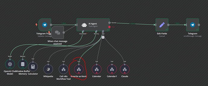

I created a Telegram bot that’s meant to rewrite articles. When testing directly, they get the expected results.
When I use the workflow by itself it works perfectly, but when I use it as a tool for an AI Agent it does not get the correct response.
Agent:
TOOL:
TOOL’s Response When use as part of another agent:

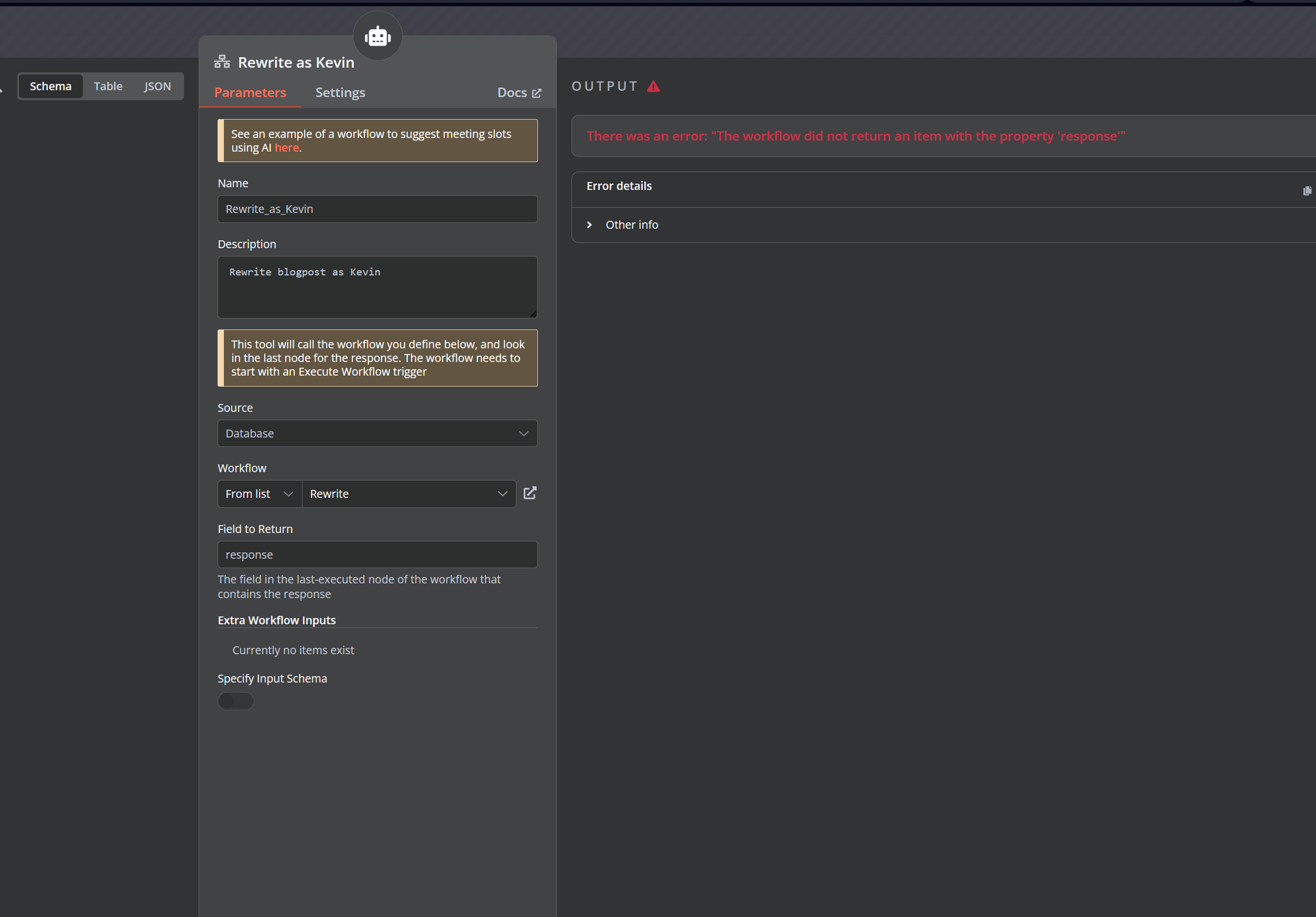

Hi @Vasislav
can you double check that the sub-workflow “Rewrite as Kevin” outputs the data in a field called “response”? Looking at your video it seems that the field is instead called “output”.
Let me know if this helps
Hey Giulio,
Thank you for the response (just saw it), you are right, now it works!
Appriciate the help!
