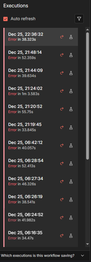

When the workflow reaches the AI Agent node, execution starts normally, but the node keeps waiting for a response for a long time and then the workflow stops executing entirely. After that, the execution fails and does not continue to downstream nodes (e.g. Gmail “Send a message”).
In many executions, the UI shows “connection lost” while the AI Agent node is running. The workflow does not crash immediately, but eventually fails after a minute and something.
This issue is reproducible and happens consistently whenever execution reaches the AI Agent node.

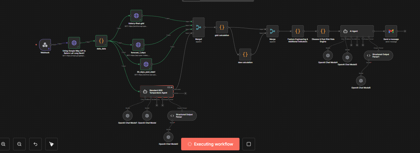

The workflow includes:
  • Multiple HTTP requests (weather history, forecast, past data)
  • Data merging and feature engineering
  • Custom calculations
  • An AI Agent node (OpenAI Chat Model) near the end of the workflow
The same workflow executes correctly up until the AI Agent node.
There is no explicit error message returned by the AI Agent node itself.

  • Execution history shows repeated failures (see screenshot)
