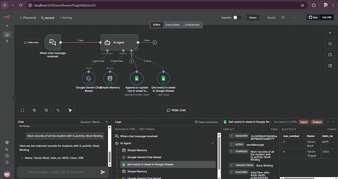

I’m working on a workflow in n8n where I use an AI Agent connected to Google Gemini, Simple Memory, and two Google Sheets tools — one for fetching rows and another for appending/updating them.
Here’s the workflow structure (screenshot attached):
  • When chat message received → AI Agent
  • AI Agent uses:
    • Google Gemini Chat Model (for LLM)
    • Simple Memory
    • Get row(s) in Google Sheets (to fetch records)
    • Append or update row in Google Sheets (to modify/add records)
The issue I’m facing is with the “Get row(s) in Google Sheets” node.
It correctly outputs 2 items (as shown in the execution output panel).
However, when the data passes through the AI Agent, the AI only receives and processes the first item and it ignores the second one.
Here’s what happens:
  • “Get row(s)” output → 2 records found
  • “AI Agent” output → Only 1 record is returned
I want the AI Agent to see and respond with all the fetched rows, not just the first one.
Is there a way to make the ai agent process all the items from the “Get row(s) from Google Sheet” node instead of just the first one?

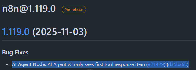

When will it be on the prod? (https://xxxxxxxxxxxxx.app.n8n.cloud/)
I have the same issue right now and the latest version that I can see there is 1.118.2
Thank you @mohamed3nan. It worked :+1:
Thanks @mohamed3nan , this also help me with the same problem !
My solution is using the AI Agent v2.2 while waiting for the n8n v1.119.0. I copy and paste from my previous workflows. But if this is your first, try copy and pasting this to your workflow
V1.119.2 still has the same issue. It doesn’t resolve the issue for my case.
Is there a way to use Agent 2.2?
Hey @lawrenceteo, where are you running your n8n?
I’m using Docker, and I updated my n8n version through command Prompt with chatGPT’s help.
Just to be safe, you should verify your version too.
I ran this command to check mine:
docker exec -it n8n n8n --version
and it returned: 1.119.0
Yes, my n8n information shows it is v1.119. I run on Google Cloud.
