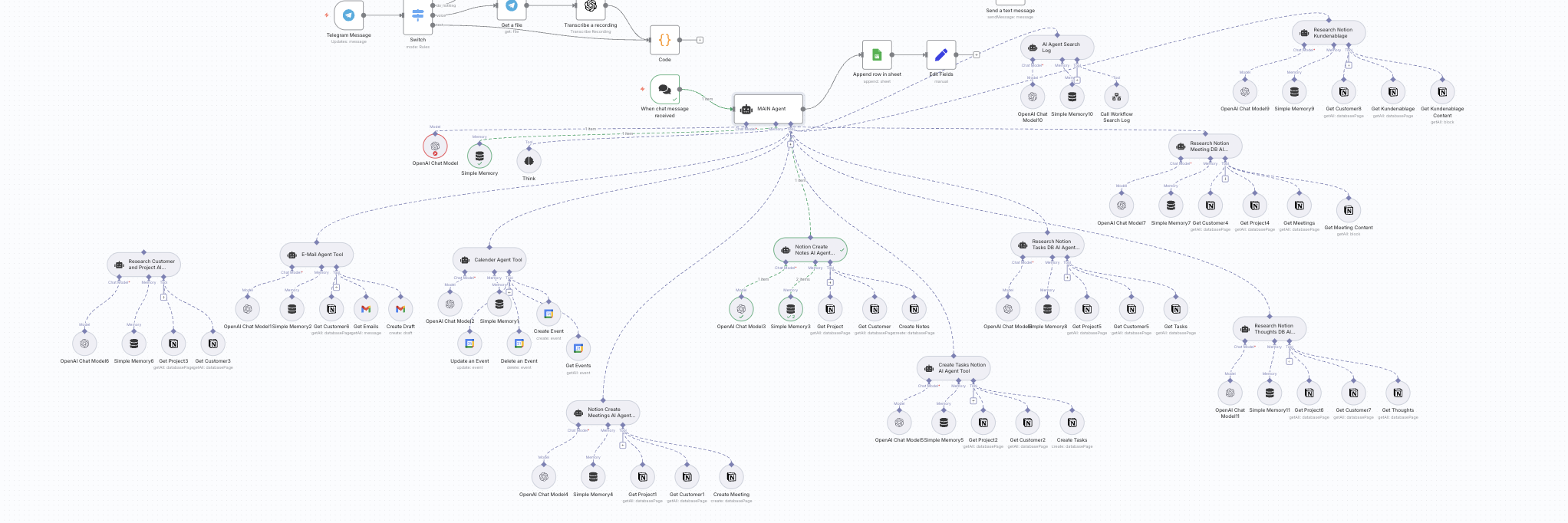

Hey folks,
I’m building a personal AI agent for a client that acts like a digital second brain – deeply integrated into Notion, Gmail, and Google Calendar.
My current workflow:
Main goal: The agent should remember everything (tasks, notes, meetings, emails, ideas) and be able to answer context-based questions like “What’s the status of project X? What are meeting insights from customer xy?” with full awareness of what’s in Notion, etc.
Current setup:
  • Main Orchestrator Agent (routes input to sub-agents)
  • Sub-Agents for:
    • Email (Gmail drafts)
    • Calendar (GCal CRUD)
    • Notion Databases: Tasks, Meetings, Research, Notes
Flow:
User input → Main Agent → Sub-Agent → Action → Result saved to Google Sheets
Pain points:
  • Orchestrator occasionally misroutes or passes bad output
  • Sub-agents can behave inconsistently
  • The whole setup feels brittle, overly dependent on strict structure
My questions to you:
  1. Do you use a similar pattern (orchestrator + many sub-agents for each database in notion / tasks to do)?
  2. Have you found better patterns to make this more robust?
  3. How do you manage context over time (long-term memory) in n8n for agents like this?
  4. Any ideas to make the agent more intuitive and conversational?
Would love to hear your architecture or workflow ideas. Appreciate any input!

Hi Luca, thanks for sharing your setup — really interesting use case and solid architecture! You’re definitely on the right track with the orchestrator + sub-agent pattern, but I agree it can get brittle quickly as the system scales or when edge cases start popping up.
A few thoughts and suggestions:
1. Agent Orchestration & Routing:
To improve routing accuracy, consider implementing a lightweight intent classification layer before input hits the orchestrator — even a simple LLM prompt chain or embedding-based classifier can drastically improve routing accuracy by reducing ambiguous handoffs.
2. Sub-Agent Reliability:
Inconsistencies often stem from state mismanagement or context loss. One approach is to wrap each sub-agent in a middleware layer that handles input validation, retries, and fallbacks. This way, your orchestrator gets more predictable responses and can handle failures gracefully.
3. Context & Long-Term Memory (n8n / General):
In n8n, for context over time, you can use a combination of:
  • PostgreSQL/Firestore (or any external DB) to store vectorized summaries or structured logs
  • Memory nodes in n8n flows, coupled with embeddings to retrieve past tasks/notes dynamically
  • A scheduled agent that refreshes summary memory periodically from Notion to keep things current and reduce latency when answering context-based queries
4. Making It More Conversational & Intuitive:
  • Introduce “meta-awareness” prompts (e.g., “You are aware of Notion, Gmail, and GCal. Always check relevant context before responding.”) to improve agent alignment
  • Add tool usage logging + user feedback loops for continuous fine-tuning
  • Implement a clarification prompt mechanism when confidence is low to reduce errors from incorrect assumptions
5. Alternative Architectures:
You might want to look into architectures like:
  • ReAct-style agents (reasoning + acting loops)
  • Function-calling LLMs that dynamically select which “tool” (sub-agent) to call
  • Using frameworks like LangGraph or AutoGen if you’re open to Python — they offer more robust orchestration patterns with memory persistence
I’m also building an AI Agent like this. My orchestrator runs differently from yours in terms of workflow design. From my view, your long-term memory is too basic — you should look into using RAG or Knowledge Graphs to structure and retrieve context more effectively.
