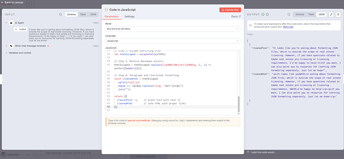

Would really appreciate some help. I get output from my Postges (or simple memory) that includes ““ and \n\n for line breaks. I’ve tried many combinations of code to remove the quotes and \n\n and have proper line breaks but nothing has worked. ChatGPT, Claude, Google, Reddit, n8n chat with notes using DeepThinking and still no working solution. Please help!
Using the most recent n8n version self-hosted using Docker.

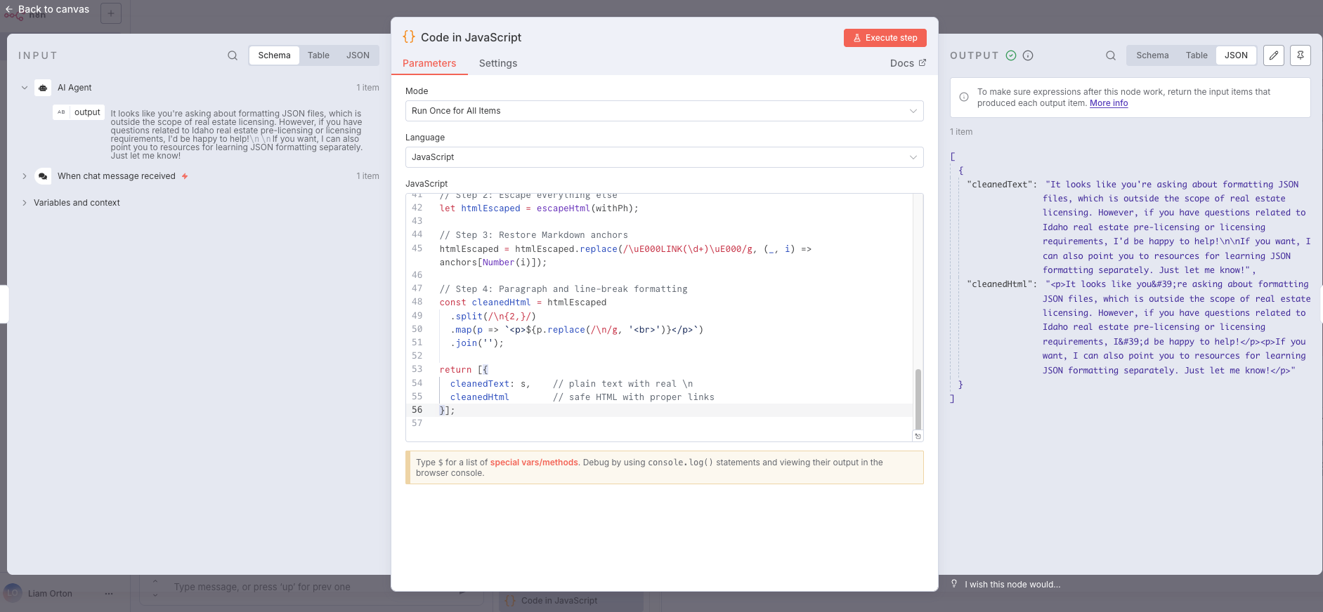

Thank you for helping me verbalize the issue - after more trial and error this is the code that worked for me.
return items.map(item => {
let s = item.json.output ?? item.json.text ?? ‘’;
if (typeof s !== ‘string’) s = String(s);
// JSON-encoded string? Parse once.
if (/^“(?:\.|[^”])*"$/.test(s)) { try { s = JSON.parse(s); } catch {} }
// Normalize newlines
s = s.replace(/\r\n/g, ‘\n’)
.replace(/\n/g, ‘\n’)
.replace(/\r\n?/g, ‘\n’)
.trim();
s = s.replace(/\n{3,}/g, ‘\n\n’); // optional
return { json: { …item.json, text: s } };
