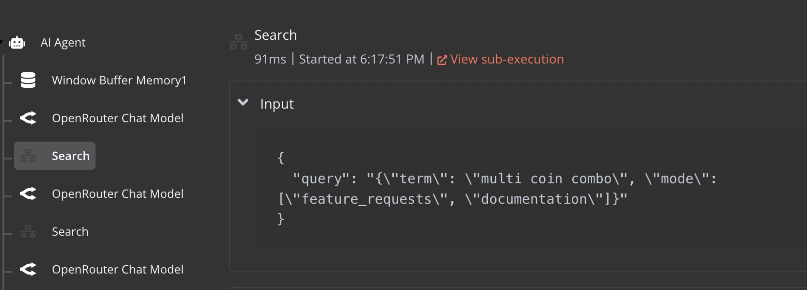

I am trying to build an agent that search in my website for information before replying a chat. The issue I am having is that the agent is not using the correct JSON format for the tool, and I can’t figure out why.
I need the agent to output this:
  "term": "multi coin combo",
  "mode": ["feature_requests", "documentation"]
But instead is using the tool with this:
  "query": "{\"term\": \"multi coin combo\", \"mode\": [\"feature_requests\", \"documentation\"]}"
I noticed this looking through the action logs, which was automatically appended to my original query:
Your output will be parsed and type-checked according to the provided schema instance, so make sure all fields in your output match the schema exactly and there are no trailing commas!
Here is the JSON Schema instance your output must adhere to. Include the enclosing markdown codeblock:
{"type":"object","properties":{"output":{"type":"object","properties":{"query":{"type":"string"},"mode":{"type":"array","items":{"type":"string"}}},"additionalProperties":false}},"additionalProperties":false,"$schema":"http://json-schema.org/draft-07/schema#"}
I think this is what interfering with my desired output, but I can’t figure out where is this text coming from.

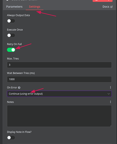

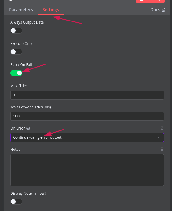

To improve chances of success you can:
  1. Add an autofixing parser
  2. Enable Retry on Fail
  3. Enable branch off on error and try to process the string with another AI node.

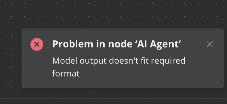

@daniel_lamphere with your suggestion I am getting a new error:
This is because is not what the subworkflow input expects, it’s still using the wrong format. The output parser is for the response of the model, not for the call of the tool, is that correct?

Yes the output parser is for the output of the AI Agent node, not for tool calls.
As for the error you are getting, this often happens when the AI generates characters that break the json syntax. Very often it wraps code with json
or markdown
You can add instructions to the prompt to not do that but it still happens.
I haven’t found a way to prevent it completely so I send myself a message and fix it manually :expressionless:
