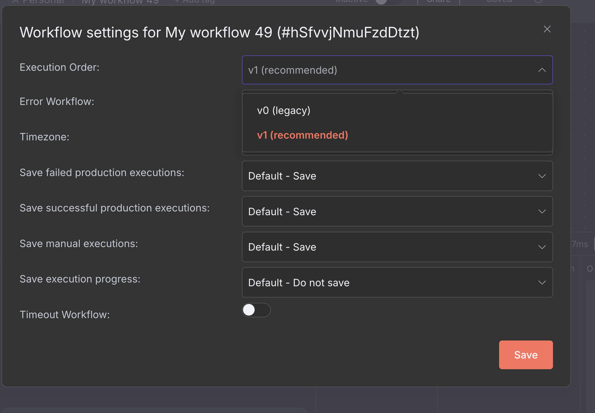

Hi there, you can go to settings, on the top right theres a 3 dots, click that and go to settings and change the Execution Order to v0 legacy
for the explanation and discussion about this topic, you can try and follow this discussion, the difference is basically
The difference is
  • v0 (legacy) executes the first node of each branch, then the second node of each branch, and so on.
  • v1 (recommended) executes each branch in turn, completing one branch before starting another. n8n orders the branches based on their position on the canvas, from topmost to bottommost. If two branches are at the same height, the leftmost branch executes first.
