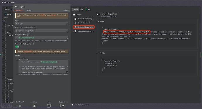

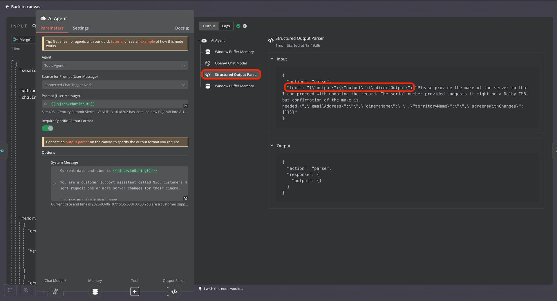

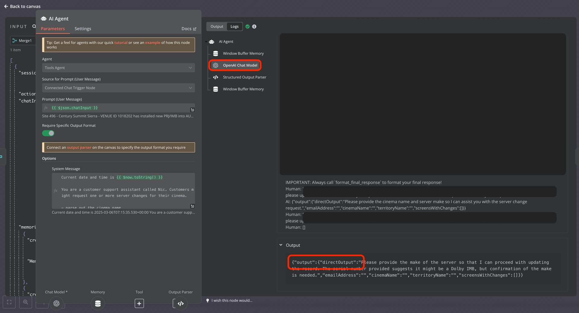

I’m seeing an intermittent bug whereby the input to my Structured Output Parser has the “output” JSON key inside another “output” JSON key, which of course fails to parse. I can’t find a pattern. I can run two exact same requests after one another, and one response will be correct, and another will be double wrapped.
Logs of a double wrapped input to the parser:

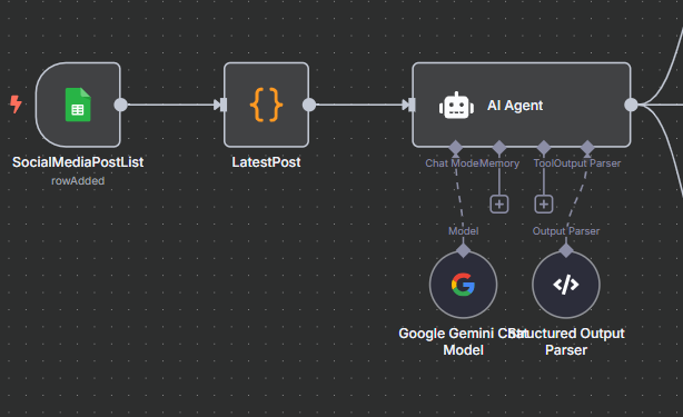

Just the necessary nodes.

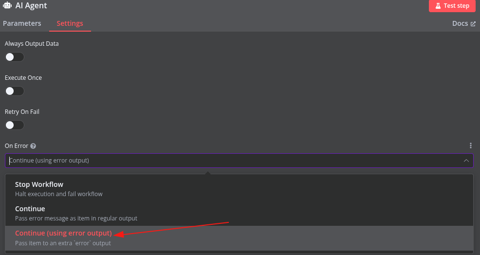

  1. You can add error handling flow in the AI node settings and try to fix the json with addtional AI prompt.
If nothing else helps make sure you add error handling and send yourself a message or an email. this way you can quickly detect failed workflows and try to rerun them manually to fix the issue.

Because I was using Postgres as the memory for the AI Agent node, the agent was saving each message to the database already containing an output field. The next time the agent ran, it would fetch that message—with its existing output—from memory and then append yet another output generated by the AI model. The cycle kept repeating.
To fix it, I forced the AI Agent to produce its output as plain text instead of JSON. That way, no JSON gets stored in Postgres. Then, only after I receive the plain‑text output do I run it through another LLM and convert it to JSON at that stage. The end goal is to avoid storing any JSON in the AI Agent node’s memory.
