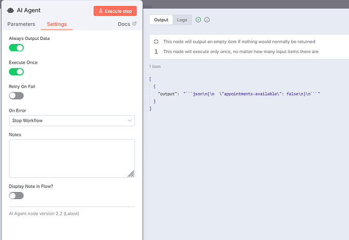

If i run the AI Agent Node from “Execute step” to test it works perfectly fine and i see the expected output reliably. The options to run only once and always output data are set, so i would expect it to proceed with some empty data if the LLM call fails.

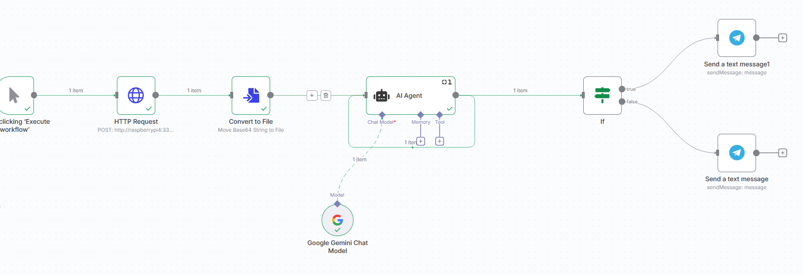

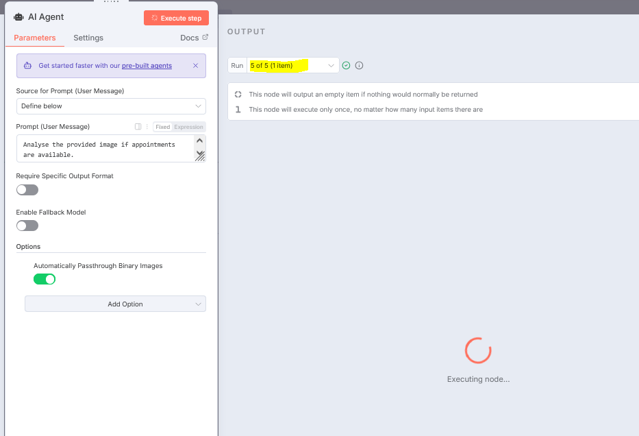

But when i execute the full workflow the AI Agent Node goes into a never ending loop.
View after the workflow got executed (until i stop it)
Interestingly when running from the workflow i see output from the model provider that the text based model cannot inspect images, but it works from execute step and gemini-2.5-flash should be multi modal.

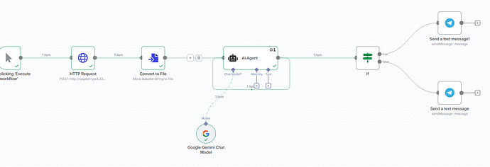

View from Execute Step:
