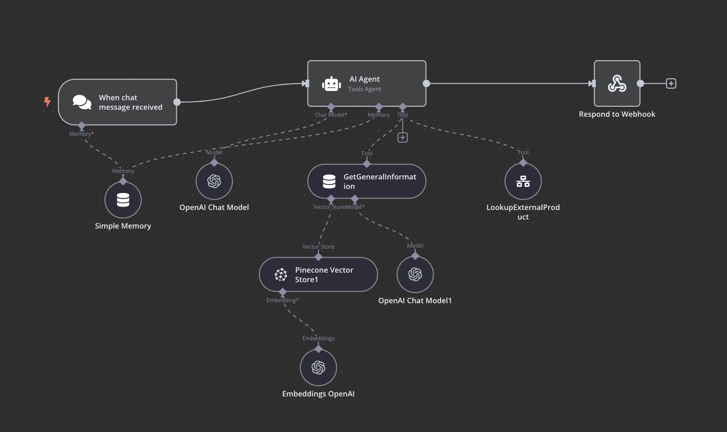

Sure thing @solomon
Main Flow
  • GetGeneralInformation looks up information in my vector store (which has info parsed from a PDF, such as opening hours, store information), This should answer in human language
  • LookupExternalProduct call another flow (see below) This should answer in a strict JSON response

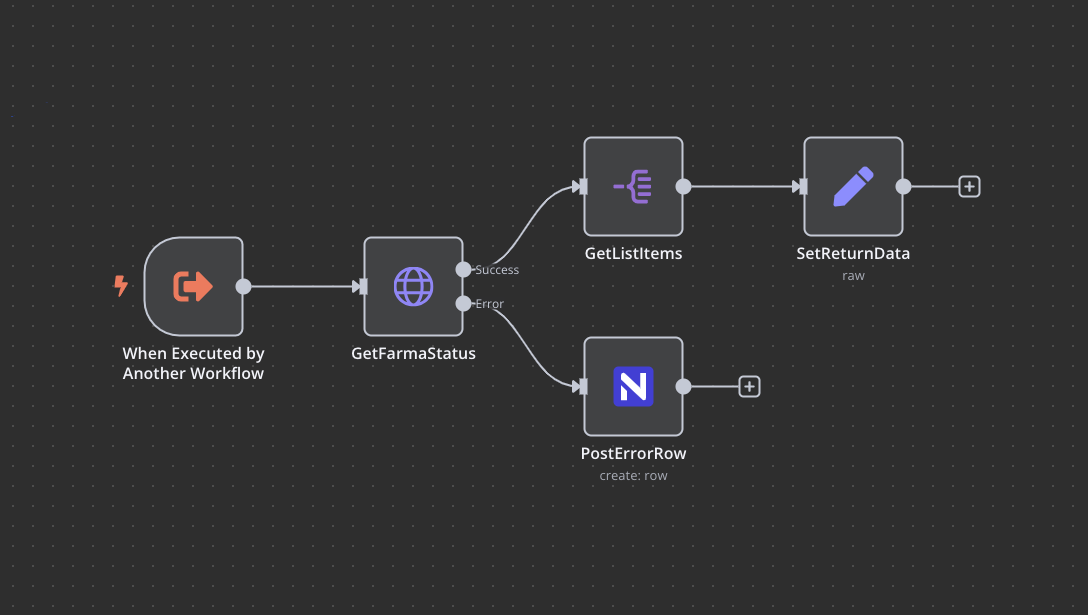

LookupExternalProduct Flow
This flow performs a GET request, and parses the correct data, this returns the following data,
  "availability": "{{ $json.notARR[0].notificationStatus }}",
  "name": "{{ $json.prescriptionName }}"
