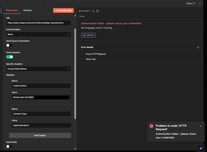

Thanks for the suggestion! I’ve already tried manual header authentication, but I’m still hitting a wall. Here is more context on what has been tested so far:
  • Scopes: I have already enabled cms.knowledge_base.articles.read and write (along with settings.read/write and crm.objects.tickets.read/write) in my Private App.
  • Manual Headers: I’ve tested the HTTP Request node with Authentication set to ‘None’ and a manual header: Authorization: Bearer pat-na1-xxxx....
  • The Error: I consistently get a 401 Unauthorized with the message {"status":"error","message":"Not engaged, auth is missing","errorType":"MISSING_AUTH"}.
  • The Mystery: The exact same Token/Header works perfectly for CRM endpoints (Tickets/Associations) but fails on any /cms/v3/knowledge-base/ URL.
  • Network Check: I’ve verified that n8n is sending requests correctly (a test to google.com works instantly), but the HubSpot Private App logs show zero incoming requests for the KB endpoint, meaning HubSpot’s gateway is rejecting it before it even hits the logs.
  • Endpoint Test: I’ve tried both the /search endpoint and the basic /articles listing, both returning the same MISSING_AUTH error.
It feels like the CMS gateway expects a specific header format or a different authentication handshake than the CRM gateway, even for Private Apps. Any idea if there’s a hidden setting or a specific Content-Type that the CMS API is picky about?"

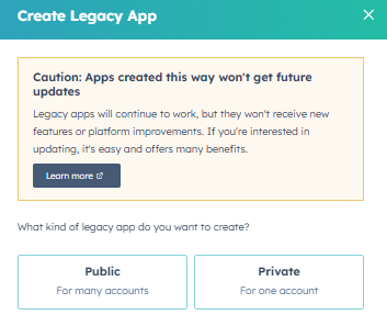

Thanks again for your response. Hubspot regrouped the private app under what’s newly called the legacy app. We can now create a public, or a private app.
IThe private app all start with pat-. I tried creating a public app, but it doesn’t not start with hp…
