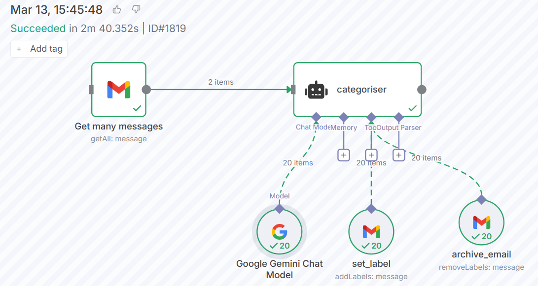

My agent is designed to add a label (set_label tool) to each email it receives and then remove the email from the inbox (archive_email tool). But for each email that the agent was given, it executed each tool 10 times. The problem was, the agent repeated each tool because it did not understand it was successful.
I finally fixed the problem when I added a Step 6. Terminate Execution
Here are the instructions I gave to my agent. Look at Step 6. I hope this fixes your problem as this vexed me for a day. Hope it helps !!!
  • Once you have successfully received a confirmation from both the set_label and archive_email tools for a specific id, your task for that object is complete. Provide a final summary of the actions taken and stop. Do not call any further tools for that id.
