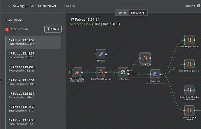

I have an AI agent that calls 2 tools, defined as sub-workflow tools, to complete his task, the keyword_intent_research and the serp_retriever tool.
Both tools are correctly called in sequence as defined in the main agent system prompt, but sometimes, the second one (“serp_retriever”) failed for an unknown reason (There was an error: “The workflow did not return a response”) while the execution of this subworkflow always succeeded (I’m checking its execution logs)
The main AI agent returns en error when calling the sub agent:
Sometimes it works, sometimes not, this is really weird and hard to debug…
The subworkflow successfully returns
Main Workflow

Make sure you last/exit node in the sub-workflow has a ‘response’ field. (you can use edit fields to set it) - AI expect this fields when returning from a tool
Well I’m not sure.
Apparently it depends more on the LLM used. I’m experiencing troubles with gpt-o4-mini but not with gpt-4o.
I have the same issue and added a response with Set and both gpt-r0 and gpt-40 mini say:
Any other idea ? @Anthony_Brebion were you be able to fix this ?
Find out a possible reason for the error, I’m using a switch and setting it to several different checks, if one of them is unanswered it will return as an error to the chat tool
