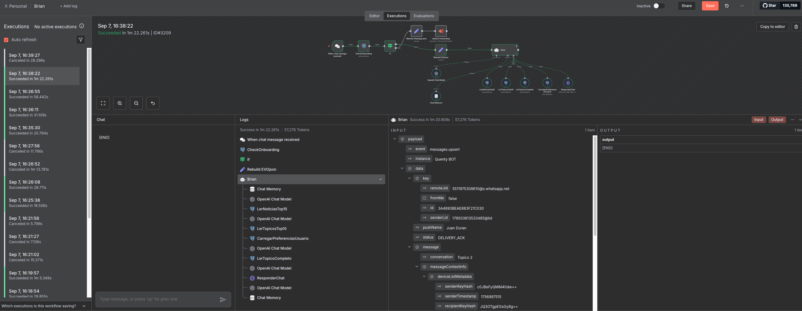

I wanted to check if someone can help me understand this random behavior from my agent, somehow sometimes an execution automatically starts multiple other executions, with what it seems are nested agents inside, no idea why this is happening…
I attached two images:
- Correct execution with all fine, all tools used, and correct output.
  • Faulty execution sometimes appears out of nothing in the logs, without any incoming trigger, as you can see in the image.
Both images can happen without any changes to the workflow, just randomly, sometimes they go well, others crash… the faulty execution usually starts a bit after 1min. of the first valid execution (react to incoming chat message)

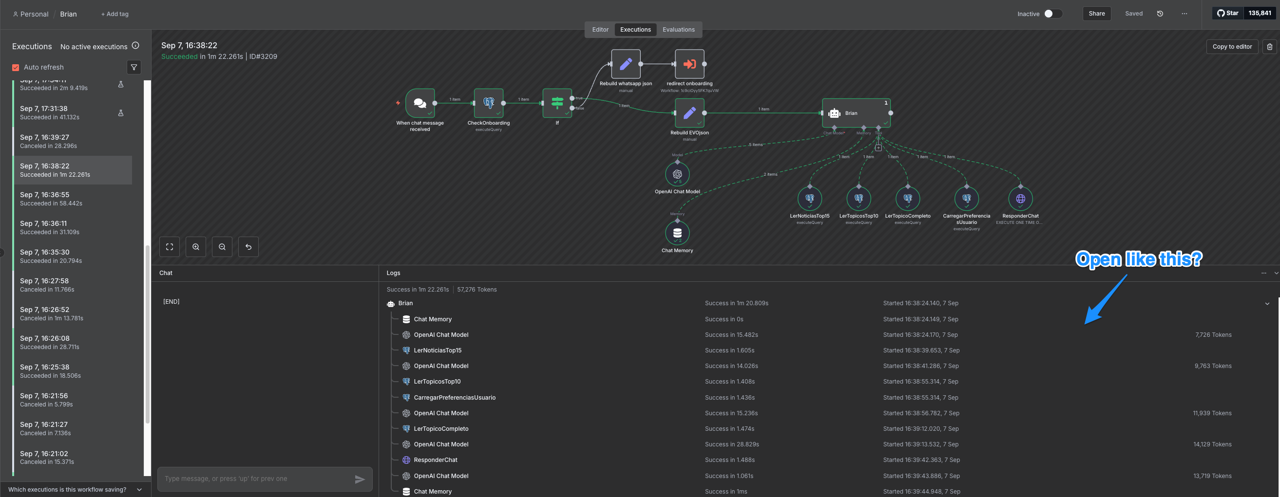

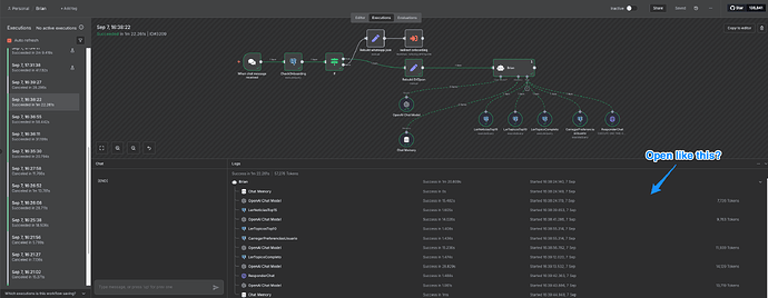

Can you show the second / green execution the same way you showed the yellow one in the first screenshot?
@jabbson Yes sure! Let me know if I understood correctly!

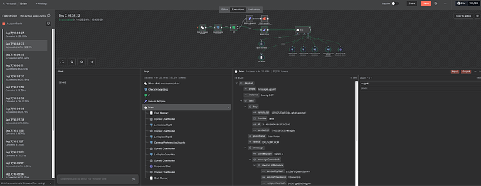

I see what you mean, what looks strange to me is that what you call the “correct execution” has an [END] for the input and the “faulty one” has a JSON for an input.

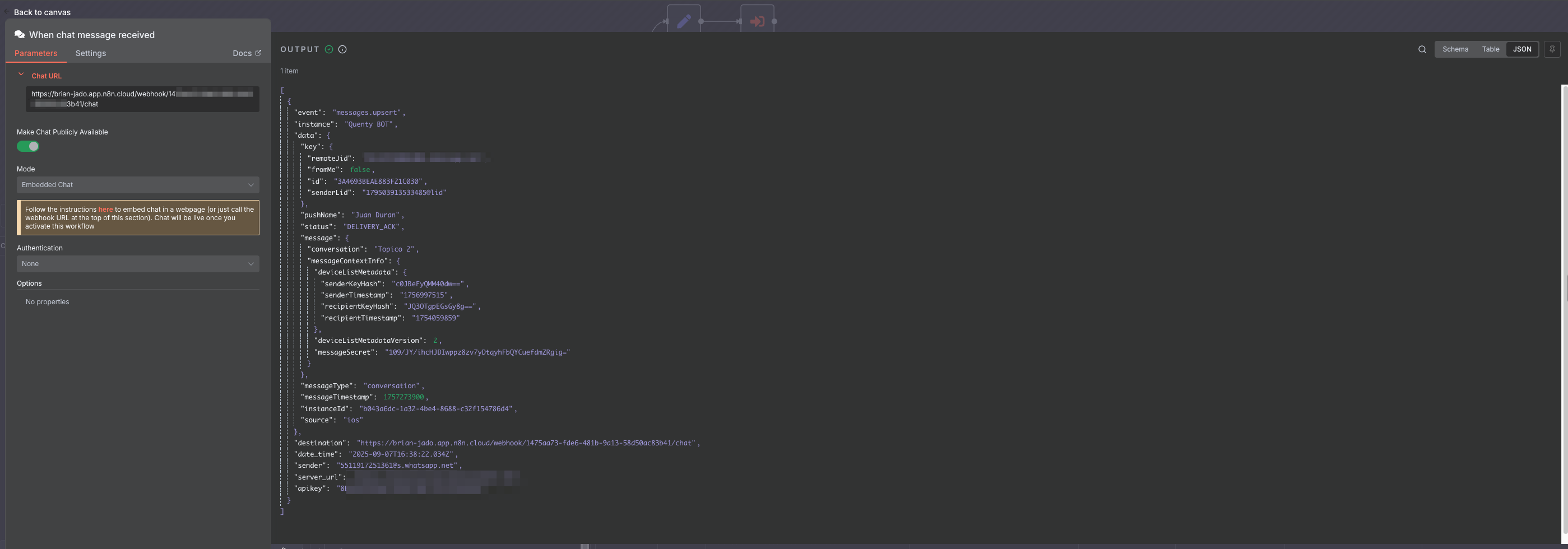

What was the actual input?
@jabbson
Here is the screenshot of the actual input.
The “[END]" at the chat interface is probably something related to an LLM answer at some point, but I’m not using the chat, I’m using a webhook. By the way the webhook is always the same structure, never changed… and it’s received only once, when it goes well and when it crashes as the two initial screenshots, webhook input is the same.

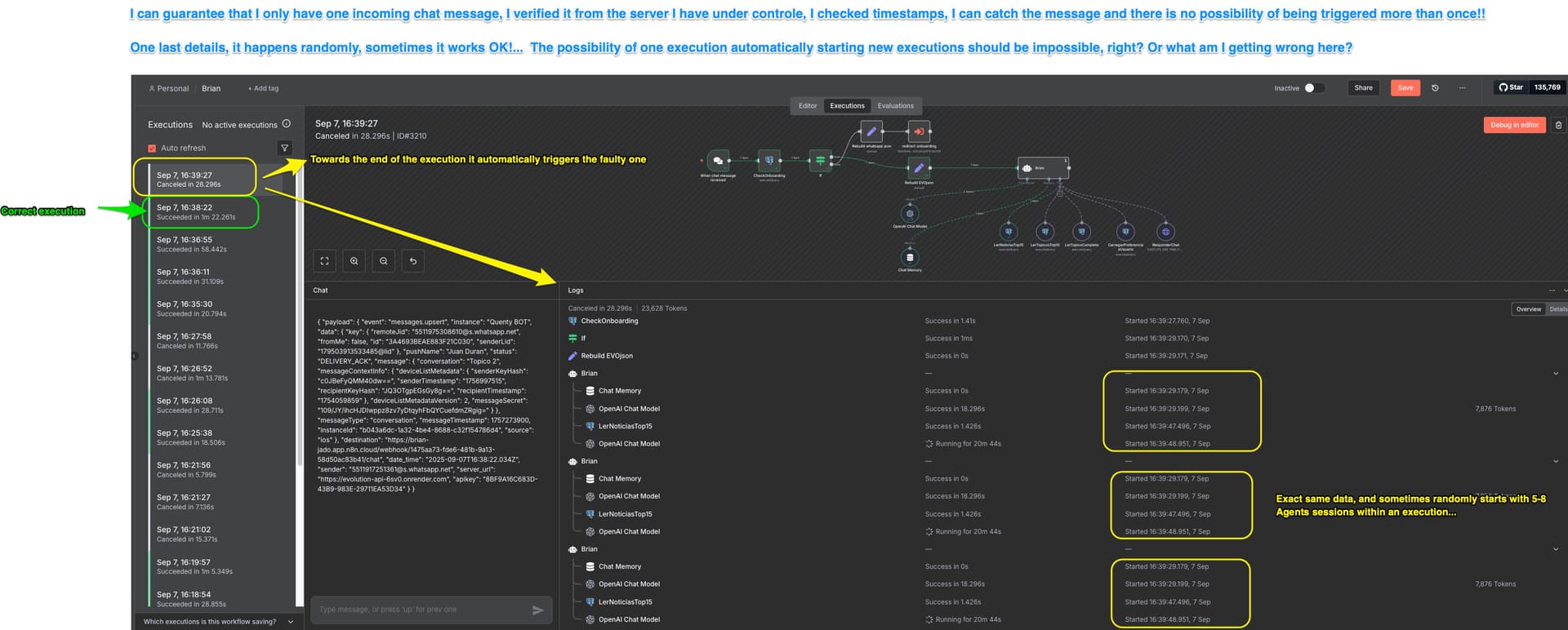

Just to provide more details:
-when I say “correct execution” is related to the perfect executions of the tools, and the correct message being sent to the end-user, meaning all agent-tools were correctly used…
-when I say “faulty execution“ is as you can see, the agent being invoking itself multiple times for more than 20min. always crashing the workflow, but the thing I can not understand is that the execution is created without any new input… it basically starts automatically, and can not even use a single tool… never… as the screenshot shows, it just starts a “faulty” execution leading to a crash. (without a real trigger)
