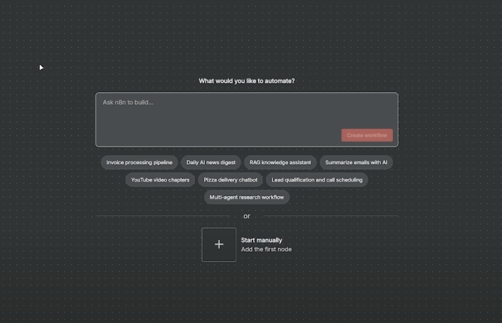

Here’s the UI I would like to have, but instead of that I just have the regular “start manualy” option.
