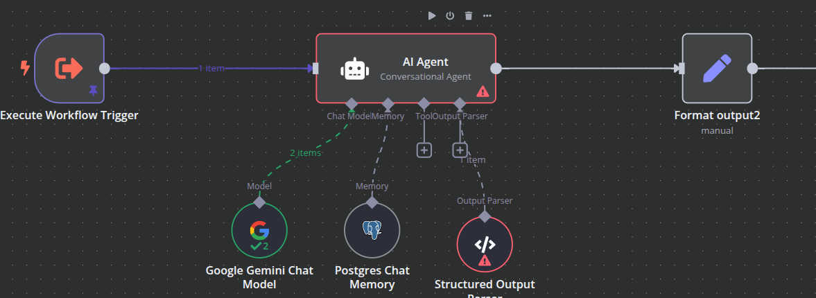

I’m encountering an issue where the AI model (likely using OpenAI or another LLM) returns different responses for the same input and prompt in my n8n workflow. This is causing inconsistencies in automation, making it unreliable for production use.
Issue Details:
- When sending the same input text with the same prompt, I get different responses each time.
- This happens in both test mode and production executions.
- I’ve tried changing the temperature and setting it to 0 (zero), but the problem persists.
- The inconsistency affects automated decision-making and workflow reliability.
The inputs are same:

Model output doesn’t fit required format
To continue the execution when this happens, change the ‘On Error’ parameter in the root node’s settings

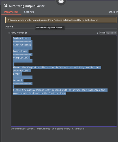

I added Auto-fixing Output, should I add retry prompt?
what do you think ?
Looking at the retry prompt, it’s essentially giving it for another round of correction to the LLM. If you want to be extra sure, you could still add an error workflow for failed executions but configure the AI Agent to still run through on error (not sure if your workflow is processing multiple items at once)

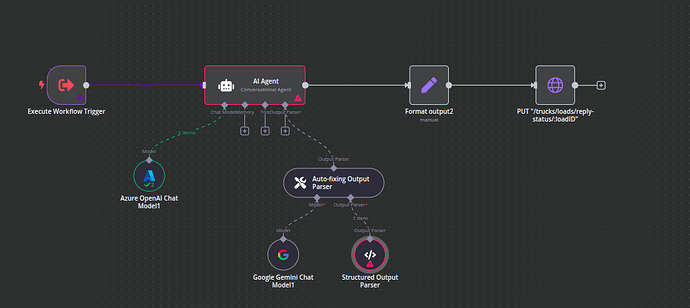

@jksr
I added retry prompt, but it is still failing
I will check it later and give you some feedback
Hmm, two things:
  • You changed the prompt in the Auto-fixing Output Parser - that’s not recommended because they use certain variable in there that give you the functionality you’re looking for

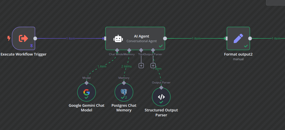

  • As soon as I am switching from AI Agent to Basic LLM Chain, I don’t have any problems any more. Could that be an option in your setup?
@jksr hey, thank you much
  • I tried removing the re-tip, but still encountering the same issues.
  • I am trying to build an agentic workflow, this workflow is sub agent and will have tools in the future
From Structured Output Parser node common issues | n8n Docs
So maybe you will habe to add a separate step for strucutred output before you pass to the agent node.
Same problem here.
If in your case you can replace the ai agent with another simple node (‘Basic LLM Chain’, ‘Infomation Extractor’), this will help you solve the problem
