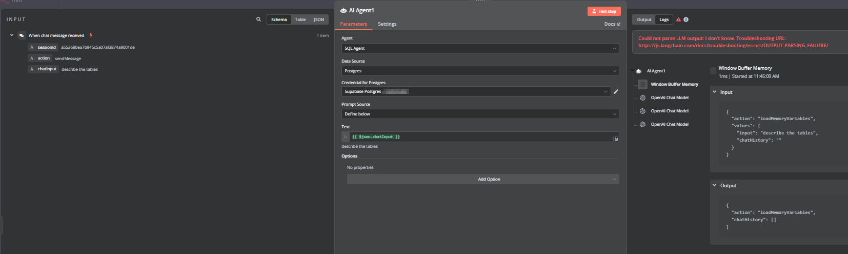

Could you elaborate on your setup please? Somehow I keep hitting this output parsing error where the workflow only has the windows chat, sql agent, gpt 40 mini and windows buffer memory nodes. Am using v 1.68.0 self hosted.
