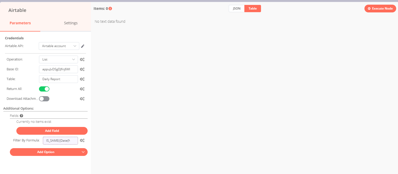

Thank you for your help.. however, when i try to use the filter formula, it is not finding anything.
Hey @Benjamin123,
The Date fields in Airtable work a bit differently. I am assuming the Date(Night) field in your Airtable has the type date and not text. If that’s the case, the above formula will not work. You will need a different formula that uses date with it.
I ran a quick test, and if you’re using the Date field, you will have to use the iS_SAME() method. In your example, it should look like IS_SAME({Date(Night)},"{{$json["yesterday"]}}")
I hope this resolves your issue :slight_smile:
Thank you harshil1712,
i wasn’t still able to find the value. is it because my “date(night)” value is inside the “fields” array and i would require it to include “field” in the filter ?
Hey @Benjamin123,
With the expression that I shared, are you still getting 0 items? I tested the formula with static date and it worked well.
hello harshil1712,
yes, i am still getting 0 item.

Hello harshil1712,
it works…thank you very much… :grinning:
but the strange thing is when i copy the same formula back to my existing work flow, it is not working…
i will study all the node in my work flow again to see what went wrong…
maybe there is a bug…i delete my existing airtable node and recreate a new node, it is working well…
