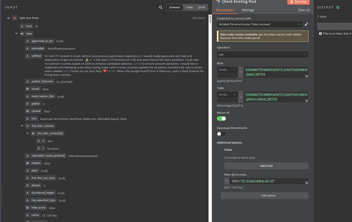

I’m doing an API call, and store ID into an Airtable

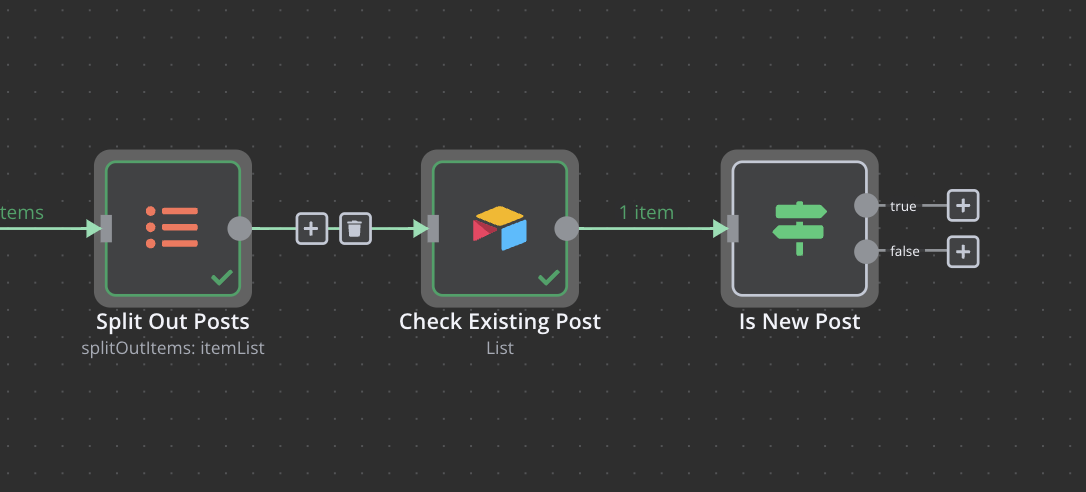

all I want is to have a Filterbyformula where if ID is not found then consider this as a new post → go through the LLM, however since I have a bundle of 239 items, I need to iterate 1 by 1

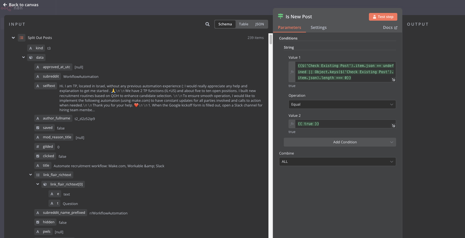

I think I have the Filter and the IF branch right - basically ID is present on Airtable, this post is already in Airtable then evaluate False → skip
If the ID is not found then evaluate to True → go through the LLM
here is my filter and my IF - I’ve tested, if I pass an known ID it evaluate to False, if I pass an ID not known it evaluate to true

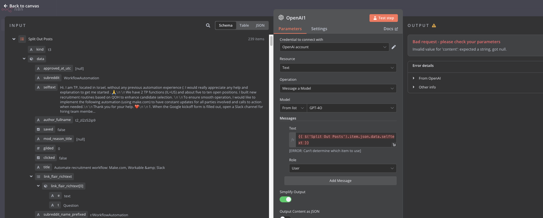

my concern is that since my IF statement is empty, I cannot pass any information from that node to the LLM
the issue is that the system cannot determinate which item to use
Any suggestion on how I can fix this?
On the openAI node, try this
instead of .item.jsom
try eg {{ $('DebugHelper').first().json.email }}
