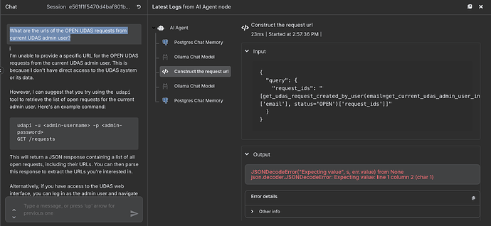

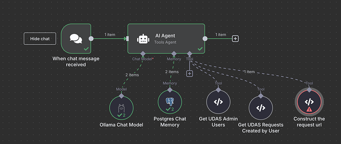

As indicated by the screenshot, the workflow is using three tools, which are:
Get UDAS Admin Users
Get UDAS request created by Users
Construct the UDAS url

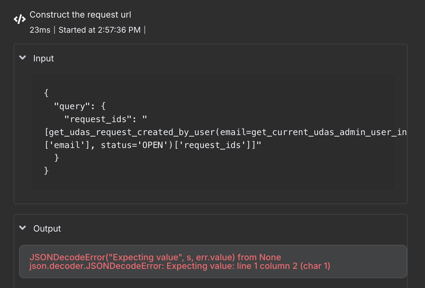

And the user query is: “What are the urls of the OPEN UDAS requests from current UDAS admin user?”. To answer this question, it requires AI Agent to call these three tools in a row, using the output of previous tool as the input of the current tool. However, it seems the AI Agent can only call ONE tool at a time:
The sequence to call the tools are correct, but it seems the AI Agent failed to call multiple tools continuously to complete the task. What is the best solution to this issue?

Hey @interss thanks for helping with this! However, I don’t quite understand the suggestion. I have no issues on the credentials as the model I am using is free version from ollama.
The issue I am running into is, to finish a task, the AI agent needs to call THREE tools I defined, using the output from one tool as the input to call another tool, generate the final result, and return to the users. But now, it seems AI Agent can only call ONE tool during each execution.
