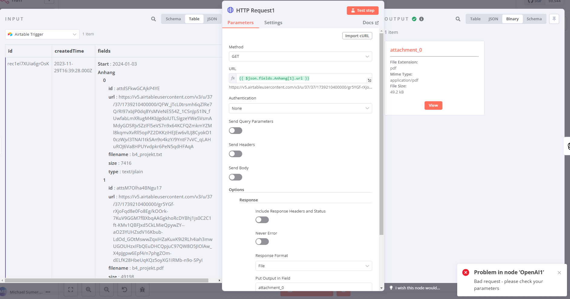

Always receiving error when trying to process attachment from airtable to openai
I am trying to fetch an attachment from airtable and upload it then to OpenAI:
But I receive the error “Bad request - please check your parameters”:
The http-Request seems to be fine and produces a binary file:
What is the problem or how can I solve the problem. I am running it with the selfhost-service on my synology-NAS.

      "parameters": {
        "url": "={{ $json.fields.Anhang[1].url }}",
        "options": {
          "response": {
            "response": {
              "responseFormat": "file",
              "outputPropertyName": "attachment_0"
      "typeVersion": 4.2,
      "position": [
        -1380,
        20
      "id": "0506ec51-ba22-4681-9f2b-1a0492fa3857",
      "name": "HTTP Request1"
      "parameters": {
        "resource": "file",
        "binaryPropertyName": "attachment_0",
        "options": {}

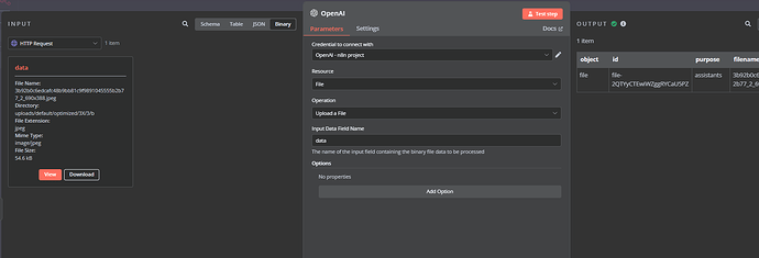

I’m on version 1.80.4 and could upload the file without any issues:
Can you try upgrading your version, please?
