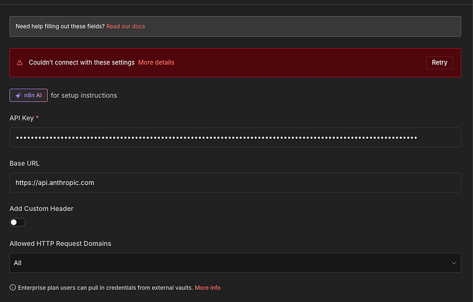

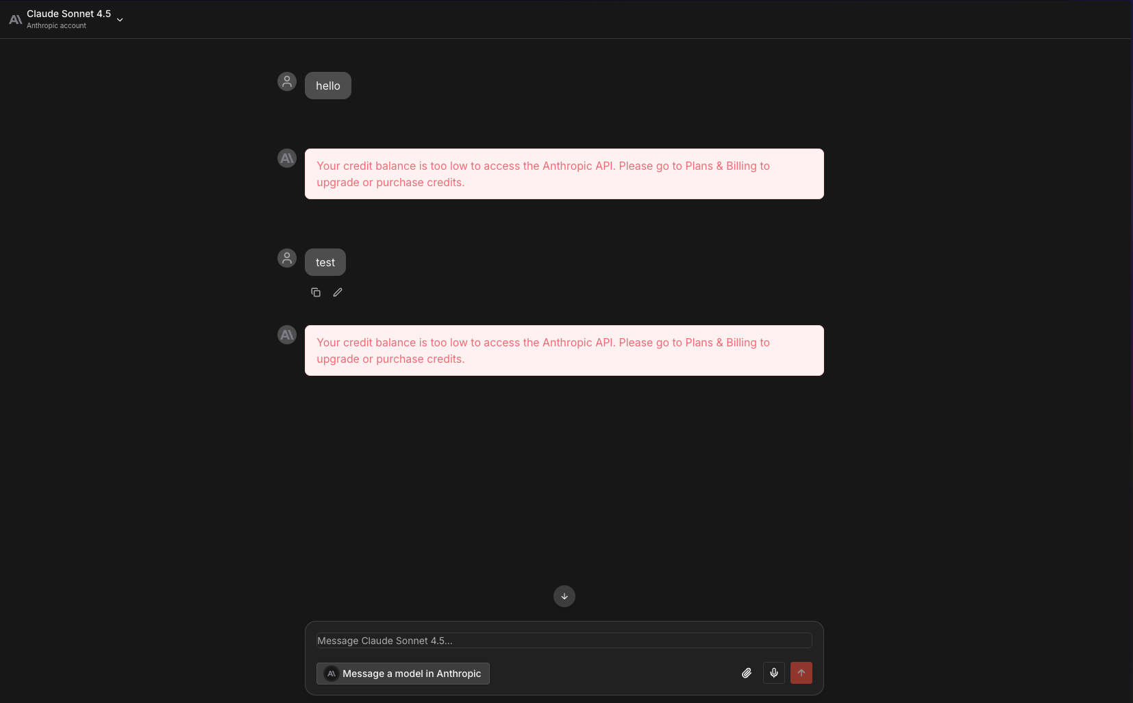

Anyone has similar issue when setting up the chat and Claude via API. I have credits in the balance (30), so that should not be the problem. I read about the issue when setting up the Claude credentials (happens to me as well), but for the life of me i can’t figure why it does not communicate.
Is this a known bug? Any fix?
I also have the “Couldn’t connect with these settings” error in a Basic LLM Chain node with an Anthropic model attached. But the node works, API calls are fine and my credits get balanced.

Does using a HTTP node gives same output? Also make sure you have sufficient credits and billing attached.. And the primary node of anthropic should work with that.. let me know about the HTTP node.
hey all thanks for reaching out. all it took was switching to expression format when inserting the API key and now everything is setup. much appreciated and have a nice day!
