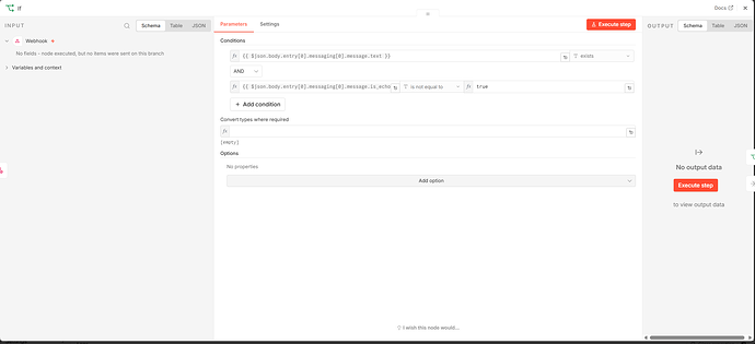

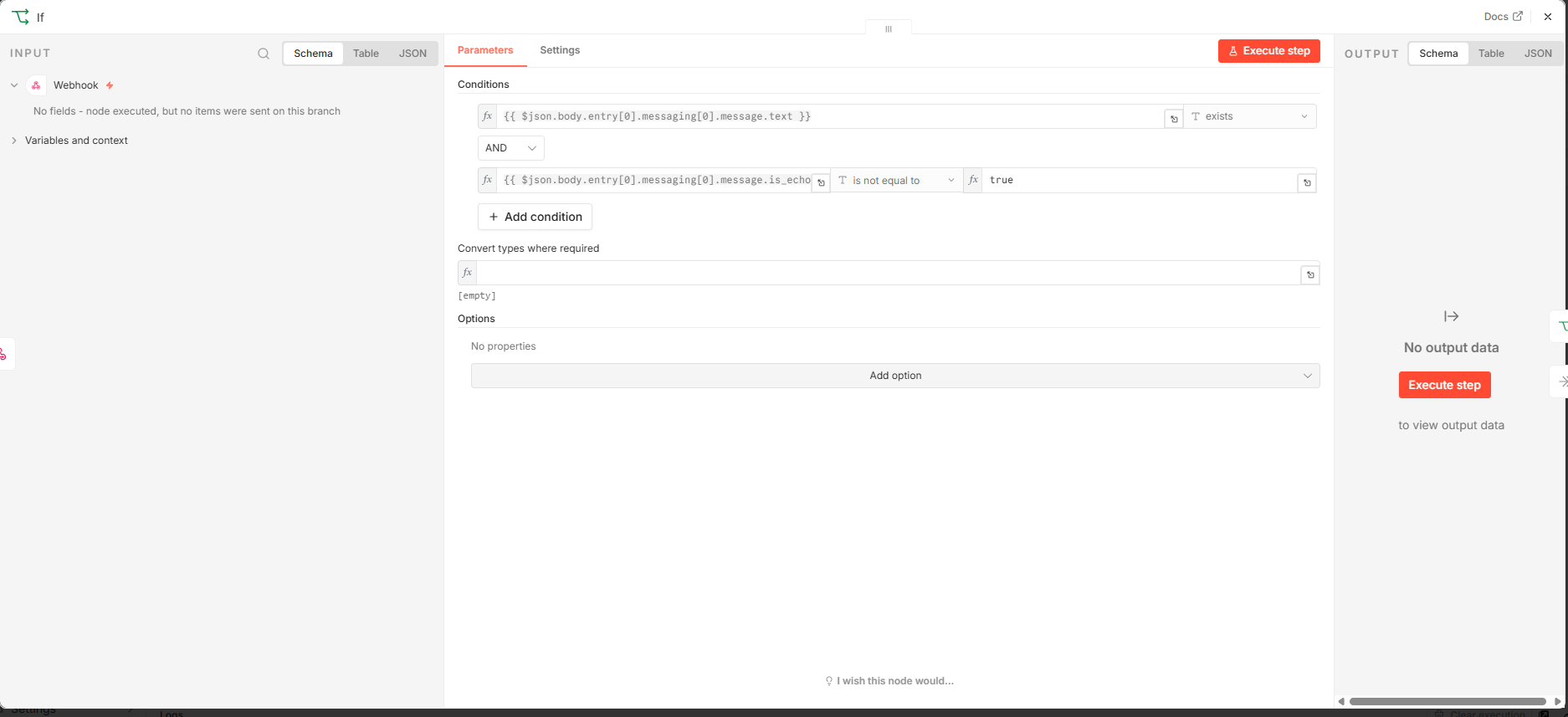

The duplicate loop happens because your AI agent sends a reply via “Send a text message”, which triggers the same webhook again, creating an infinite cycle. Your is_echo filter is on the right track but has an issue.
The fix:
  1. Your is_echo check is comparing to a string "true" instead of a boolean. In your If node, you have is_echo is not equal to true but true is in the expression field (fx), meaning it’s being treated as a string. Facebook Messenger sends is_echo as a boolean true, not the string "true". Switch that condition to use the boolean comparison, or better yet, flip the logic: check that is_echo does not exist rather than checking its value.
  2. Add a sender check as a safety net. Even with is_echo, add a condition that compares the sender ID against your page ID. Something like: {{ $json.body.entry[0].messaging[0].sender.id }} is not equal to YOUR_PAGE_ID. This guarantees the bot never processes its own messages.

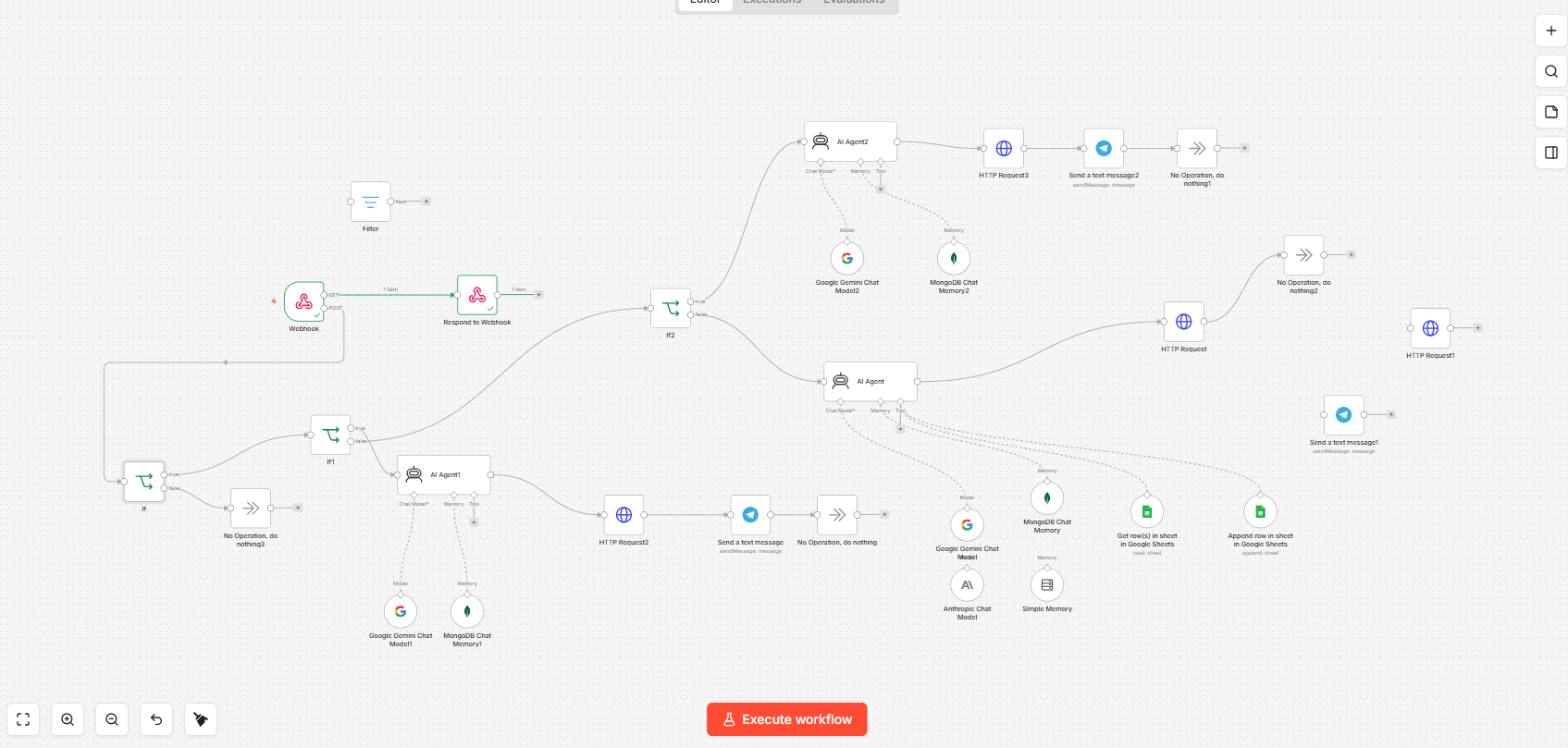

  3. Your routing logic can be simplified. Right now you have If → If1 → If2 cascading into three separate AI agents with separate memory and models. Instead, use a single Switch node with three outputs: one for image attachments, one for image-related keywords, and a default for everything else. This avoids the nested If chain and makes the flow cleaner.
  4. Make sure “Respond to Webhook” fires immediately. It looks like it does from your screenshot, but confirm it returns 200 to Facebook before any AI processing starts. Facebook will retry the webhook if it doesn’t get a 200 within 5 seconds, which also causes duplicates.

Your first IF checks: message.text exists. When a user sends an image, Facebook Messenger sends an attachments array but no message.text field. So the first IF correctly says “text doesn’t exist” and routes to false. The image message never makes it past that gate.
The fix: change the first IF node’s condition from AND to OR:
  • message.text exists OR message.attachments exists
  • AND is_echo is not equal to true
This way both text messages and image messages pass through to the routing logic below.

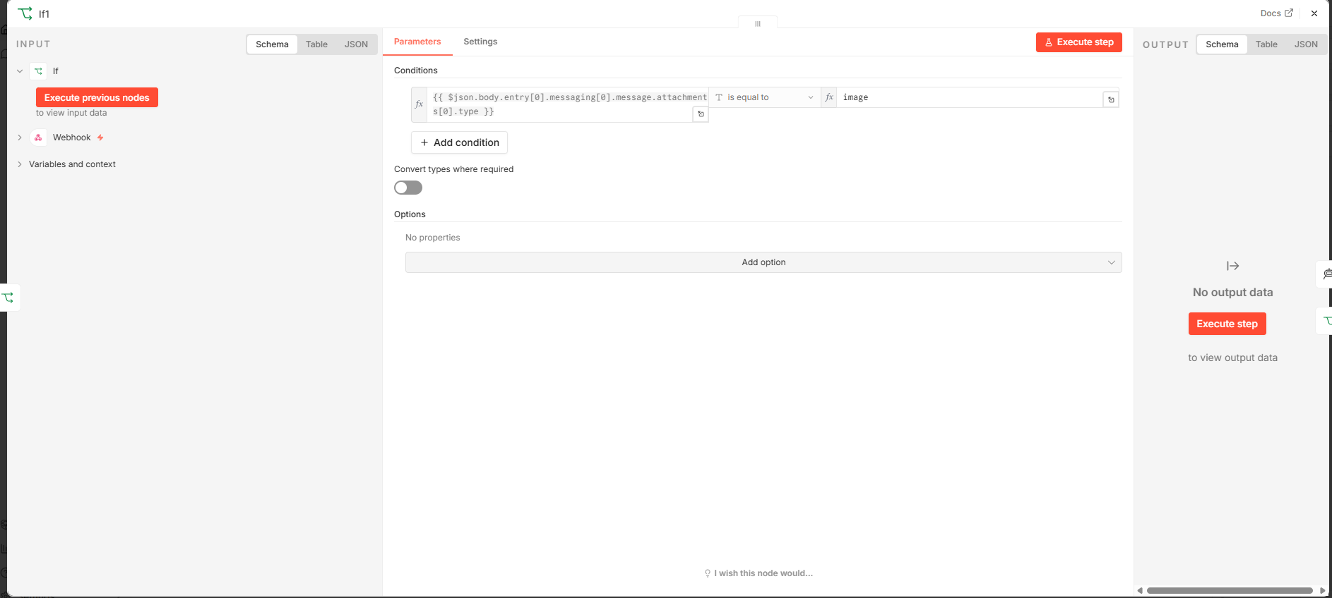

Then your IF1 node (checking attachments[0].type equals “image”) will actually receive the image messages and route them to the right AI agent.

In my current flow:
  • After the Webhook, I have IF Node 1:
    {{ !!$json.body.entry[0].messaging[0].message && !$json.body.entry[0].messaging[0].message?.is_echo }}
    If this is true, it goes to IF Node 2.

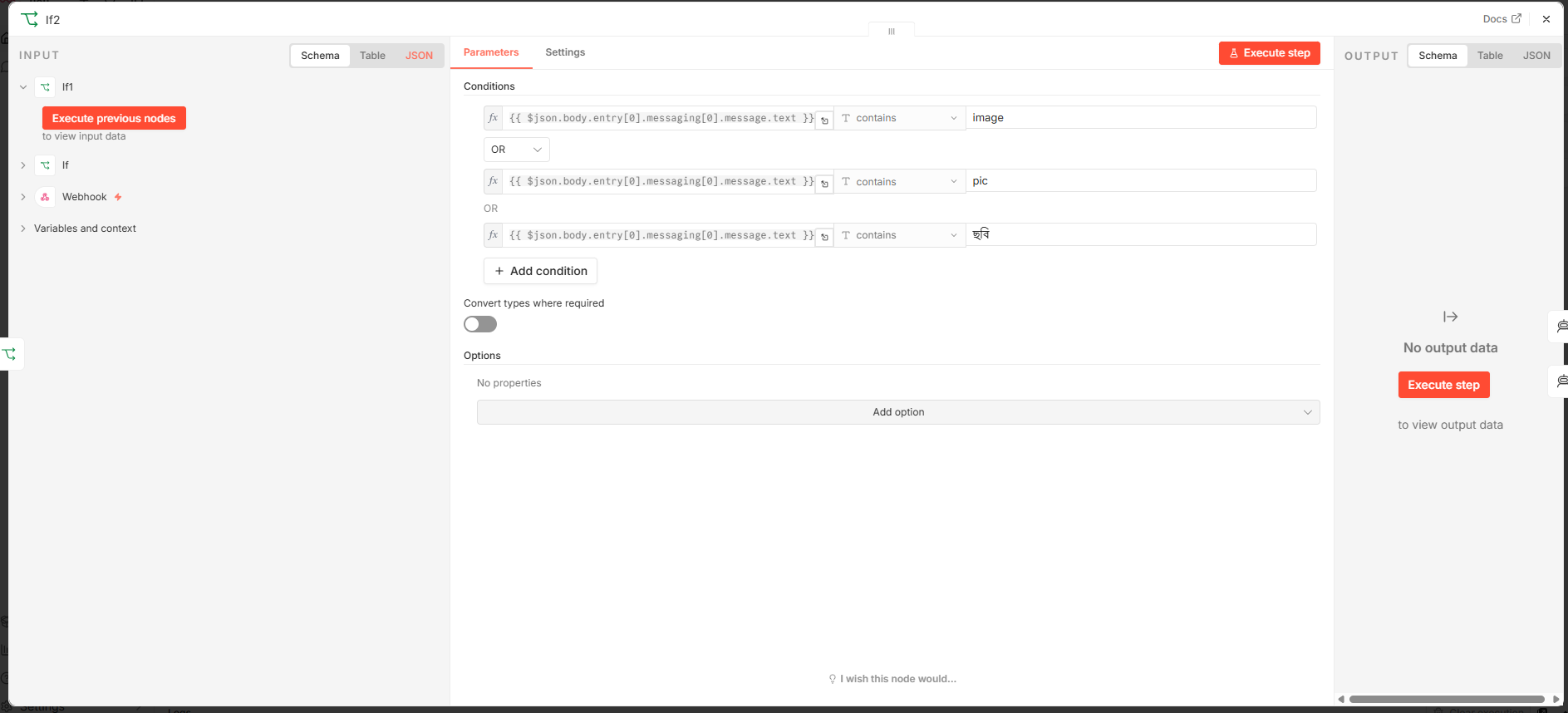

  • In IF Node 2, I check:
    {{ $json.body.entry[0].messaging[0].message.attachments?.[0]?.type || '' }}
    If it is equal to "image" or "audio", then it goes to AI Agent 2 for a response.
    If false, it goes to IF Node 3.

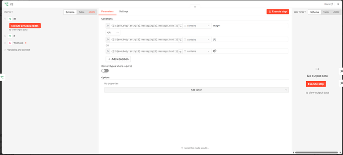

  • In IF Node 3, I check:
    {{ ($json.body.entry[0].messaging[0].message.text || '')
        .toLowerCase()
        .match(/image|pic|chobi|ছবি/) ? true : false }}
    If true, it goes to AI Agent 2.
    If false, it goes to AI Agent 3.
