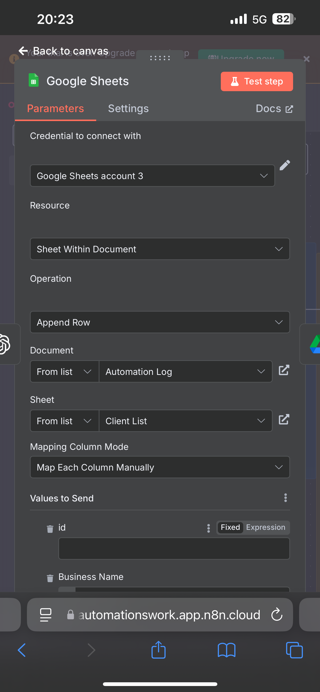

I have a workflow that is working - output is from the ai agent to the append row sheets node, I didn’t have any issue setting this up - worked straight away, however make sure you use a JSON output from the AI node, you select this in settings.
The columns were mapped manually :

hi guys for me i solve the problem with making the google sheet
in that setting the problem i think due to the format so let the AI agent handle it and i think it will solve the problem
so the steps is
1 - make Map each column manual
2 - and let it the agent identify it
i hope it work for you all
