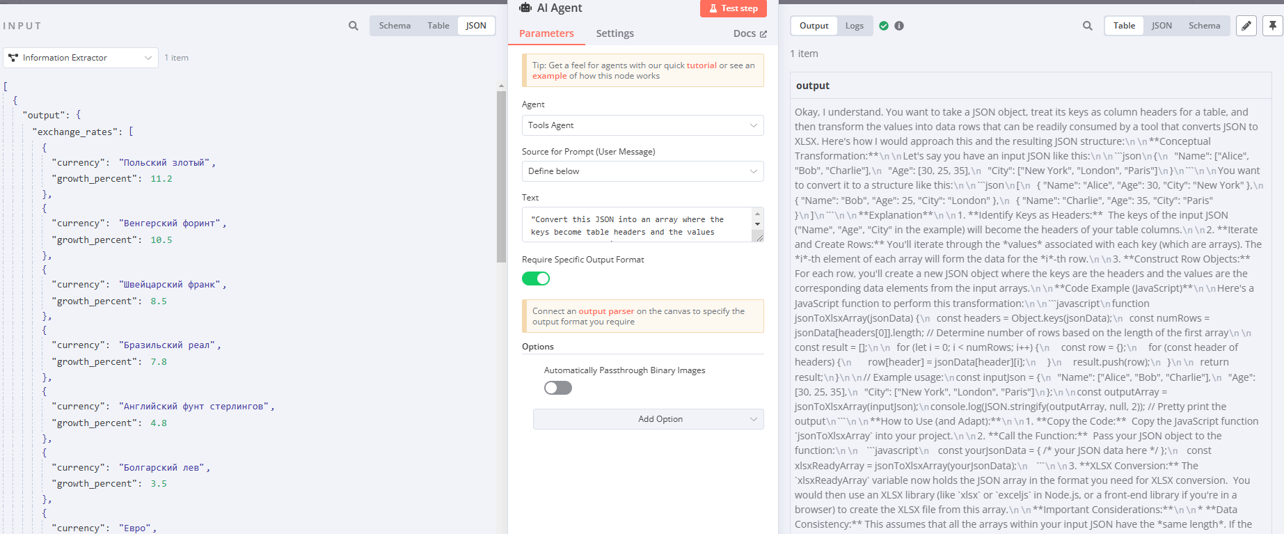

    1.78.1
Hey @V_I - I am not a 100% sure from the screenshot you posted, but do you actually use the JSON of the “Information Extractor” Node in your prompt? You should use an expression for that and reference the JSON {{$json}} to give the agent the context. If you just want to build a table, I could imagine it’s easier to ask the model to output CSV and specify how your header maps to the JSON structure. Excel or google sheets can import CSV. For more help, it would be good if you can the workflow or relevant parts of it.

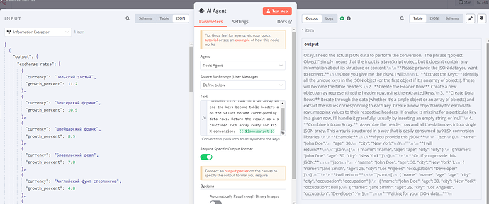

I get the problem, but I can’t see what your agent node is doing. You said it doesn’t recognize the incoming JSON, but did you reference it? See here for details: Current node input | n8n Docs
Do you mean this? When isert the parameter {{ $json.output }} in the prompt, the agent still does not see the JSON.
OK, that’s strange, maybe you can try like this. So set your instructions as system message in options. Pass your JSON as user message
thx your solution works, but the same result can be achieved simply by adding a “JSON to XLSX” node without using an AI agent. My problem is that I want to generate an XLSX file in a readable format, but the output I get is not properly formatted. That’s why I want to use an AI agent to correctly format the XLSX table.

No, the LLM does not “see” the output parameter that is being passed to it.
