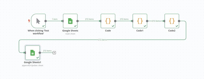

My workflow looks like that
I want it to convert data from one sheet to another.

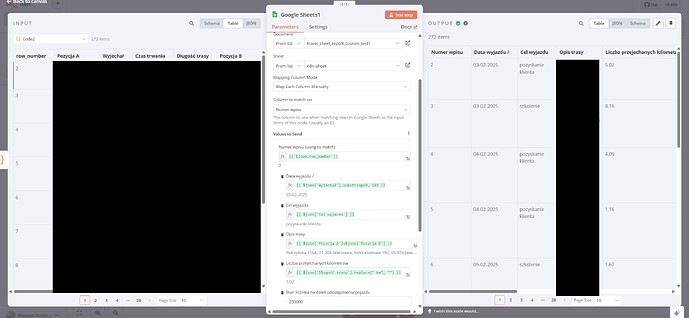

When I check test workflow all input and output data are correct
and in the way i want
It is how last node looks:

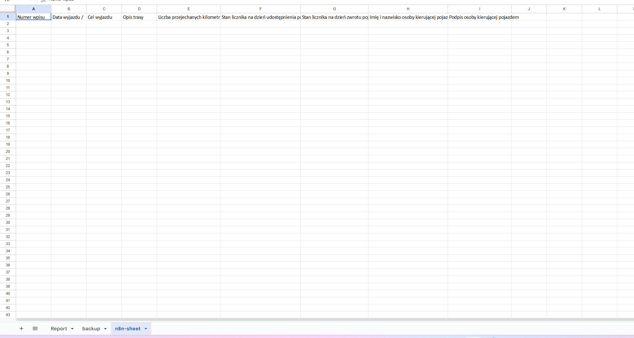

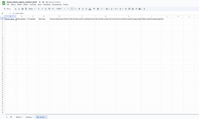

But in the sheet nothing shows
I do not know where I did a mistake.
all authorizations are ok because i can input new data to the sheet without modyfiing it
Names of colums seems ok because not “can see them”
Can you tell me what I am missing?

Just in case: try scrolling your target sheet all the way down to see if the data has been appended somehere. A couple of Ctrl-Down should get you there.
There were reports of this sort behaviour, reasons are not clear though. My guess would be that there still can be some “invisible” data (e.g. formulas that resolve to “” and hence not visible but formulas still count as data) on the sheet causing n8n/Google to pick the “wrong” row to start adding new data at.

Not sure if this is the root cause, but at a quick glance this expression previousAddresses[positionB] and other expressions of that kind may resolve not as expected. This will create a key with contents of positionB variable.
You may wanted to use previousAddresses["positionB"] or previousAddresses.positionB instead.
E.g. if positionB === 100 then previousAddresses[positionB]++ will try to increment previousAddresses["100"], not previousAddresses["positionB"].
Disregard this if you truly intend relative addressing like this and items like previousAddresses["100"] are defined and hold values that make sense. I just do not see the underlying data to test the hypothesis.

You’ve got a plenty of data on the n8n-sheet. See rows 545+
There are some values in column Numer wpisu that match the Update condition, hence no new rows added.
I added a column to store Timestamp for debugging purposes. This helped me to make sure the workflow works. Just not as expected.
And n8n will try to append any new data past last row in use. It won’t fill in gaps.
So try to delete obsolete data by selecting all rows (not just cells) from row 2 till the very end and delete via context menu action. Or simply set up a new sheet to collect outputs.
