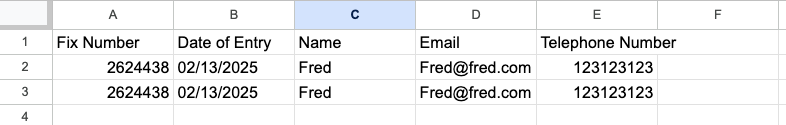

I have a unique number (called Fix Number) and if that Fix Number is the same I would like to overwrite that row. If the Fix Number is different then it should create another row (append). What I am finding is that every time I test with the same Fix number I get another row, I was hoping just to see one entry in the sheet.
This is the entry in Google Sheets

Did you add this two line both by the email ? I just wanna make sure that they are the same, maybe there are something different in data type.
Hi - they are both by email.

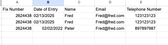

I’ve just sent another with the same unique Key, my thinking is that I have a unique key so the row would just be replaced instead I have another entry/row. Or is my understanding on Append or update row wrong?

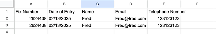

Your code definitely handles all inputs as text, while from data formatting in column A Google Sheet treats stored data as numbers. So server side it may indeed compare text (sent by you) with a number (stored in the sprreadsheet), just as @solomon suggested. If .toNumber() doesn’t work for you, then maybe try changing the formatting on spreadsheet side by setting the Column A format explictly as plain text.

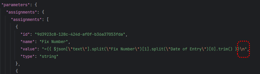

Upd: Make sure you do not have any whitespaces before {{ or after }} in your expression. I was able to reproduce the behaviour you observe by adding a whitespace outside the expression brackets.
Upd: Here you go. You’ve got one in the Edit Fields node.
A very subtle bug to catch!
