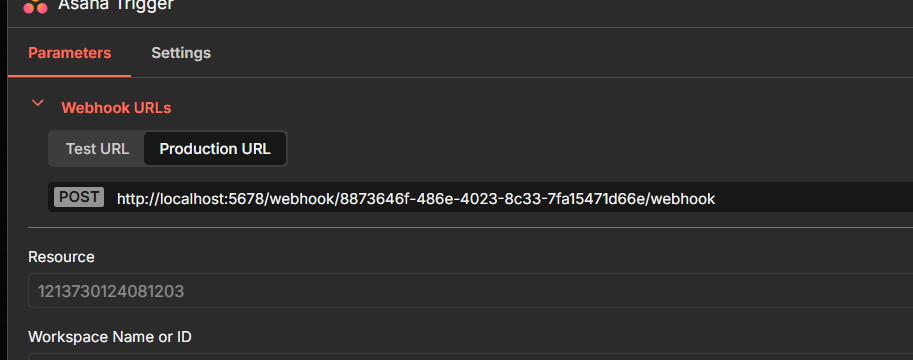

Trying to set up some automation through n8n with Asana. When I try to use the trigger node, I receive a 403 error. With other nodes like “Create Task”, “Delete Task”, etc., there are no problems at all, everything works fine.
Also, the most important thing to mention is that even though I have Cloudflare Zero Trust set up, I have other nodes that also work with webhooks and I don’t have any problems there at all. All other workflows are working absolutely fine.

Are you using localhost for your webhook URL? If so, Asana won’t be able to reach it.
No, I am not. I have a domain name connected to n8n: n8n.coop.pp.ua
And as I mentioned, I am already using other webhooks and they are working fine.

Solved, free Cloudflare plan with “Bot fight mode” ruined everything.
I’ve already marked the correct solution earlier in this thread, but I decided to write a detailed explanation because some of the suggestions here are simply not applicable and do not work in this specific case.
In my setup, I’m using Cloudflare Zero Trust and have it configured to bypass all traffic on a specific subdomain used for webhooks. However, when I tried to use the Asana Trigger node in n8n, it still wouldn’t work. The error looked like this:
Problem running workflow
Show Details
Asana Trigger: The remote server which is intended to receive the webhook responded with an incorrect status code: 403
Even though all the relevant firewall rules were disabled or set to bypass, the issue persisted. After digging deeper, I discovered the real problem was Cloudflare’s Bot Fight Mode.
Important detail: on the free plan, you cannot disable Bot Fight Mode per application or subdomain – it’s enabled globally. That means even if you configure bypass rules for your webhook subdomain, Bot Fight Mode can still interfere and cause 403 responses for Asana webhooks.
So the solution is:
- If you are using Cloudflare (including Cloudflare Tunnels), disable Bot Fight Mode globally; or
- Upgrade to a paid plan that allows you to turn off Bot Fight Mode for a specific app/zone and then disable it only for the application you use for webhooks.
After disabling Bot Fight Mode, the Asana Trigger node started working correctly and the 403 error disappeared. I’m pretty sure this behaviour will be the same for other webhook-based trigger nodes behind Cloudflare as well, so it’s worth checking this setting if you see similar 403 errors.
