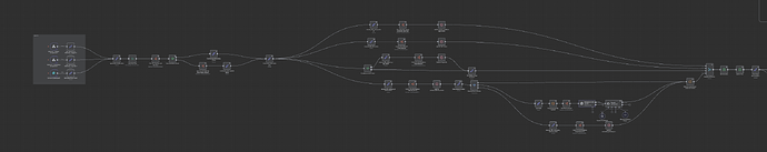

I need help regarding a 4-branched workflow, which needs to run on parallel and async.
Issue: Each branch executes seamlessly individually, however when I run the whole workflow as one, the workflow doesn’t return any output and only a couple of branches react as expected.

besides missing multiple merge nodes. keep in mind that when you branch your flow, each branch will be executed from top to bottom.
for example in the below workflow Http #1 executes first and after a couple of seconds (10 seconds approximately) http #2 executes and then after a couple of seconds, the merge node executes
so these two branches do not execute asynchronously
With “do not wait” enabled on all branches, they fire and forget, so the main workflow continues without collecting their outputs. If you need the results from all branches, you cannot use “do not wait” because the merge node will never receive data.
Remove “do not wait” and let branches run truly parallel. If timeout is your concern, add individual timeout settings per sub-workflow or use Split in Batches with Wait node between batches to control execution flow without losing outputs.
Check execution logs to confirm sub-workflows are actually completing when fired async.
