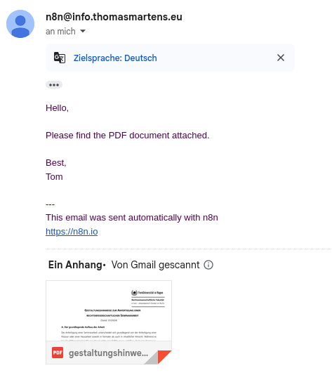

I just tested the workflow with the Send Email node:
However, I still seem to be getting the expected PDF:

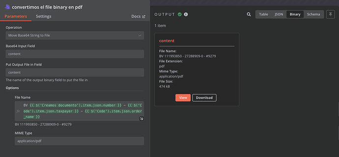

Could it be that the error is because I am converting it before?
Quite possible! Perhaps you can share a screenshot of the binary output of your Obtenemos documento en pdf and convertimos el file binary en pdf nodes?
Here:
In the gmail node it attaches well as pdf but in the Send Email it leaves it as binary.

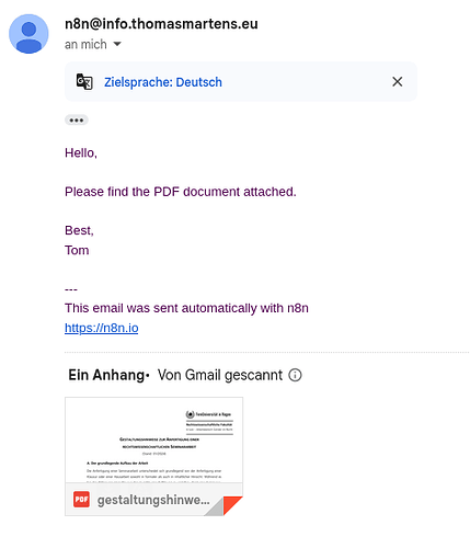

Oh, could the problem be that the filename field itself does not include .pdf? When trying to send a file without this suffix I am getting a result like this:
When using a filename ending with .pdf the message looks like so instead:
Perhaps you can try adding .pdf at the end of the file name in your convertimos el file binary en pdf node? Like so:
@MutedJam
I added .pdf to the name and it worked perfectly.
