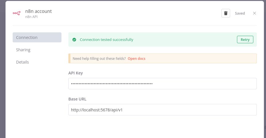

On the actual issue, I can’t seem to resolve n8n.us.incognia.tech from my end:
So I am wondering if your n8n instance might not be able to resolve this URL either? Perhaps your instance is able to talk to itself via http://localhost:5678/api/v1 like below?
Also, make sure you don’t have any trailing or leading spaces in your API Key field when seeing Authorization failed messages.
