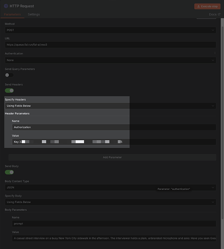

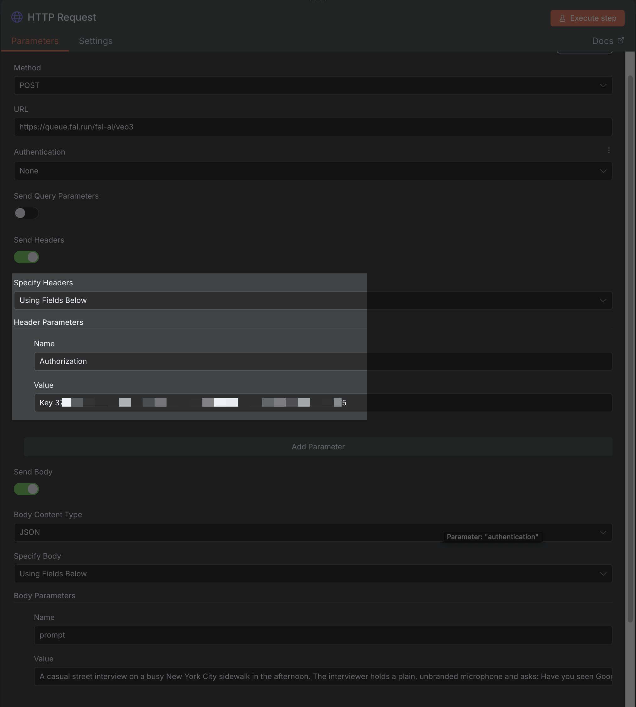

Hi everyone ,I’m trying to build a workflow in n8n that sends a POST request to Fal.ai’s veo3 endpoint (https://queue.fal.run/fal-ai/veo3) using the HTTP Request node to generate AI videos. I’ve manually added the correct headers including `Authorization: Bearer
andContent-Type: application/json, and I'm sending a valid JSON body with a prompt and style. Despite this, I keep getting the error: “Authorization failed – please check your credentials. Cannot access application 'fal-ai/veo3'. Authentication is required to access this application.” I’ve verified that the Bearer token is correct, enabled “Send Headers,” set the method to POST, and even tried switching between predefined credentials and manual headers. I'm not sure if the issue is with how n8n sends the request, or if Fal.ai’s veo3` endpoint requires special access. Has anyone successfully connected to this endpoint through n8n, or know what might be causing this authentication failure?

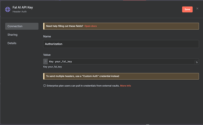

The key should be
Key abc-abc-abc-abc
Notice there is a space between key and abc-abc...
Hello @Adebisi_Oluwaseyi, welcome to community!
So, instead of using Bearer, you need to use Key, also you need to revoke your key right now, because your key exposed here:)
Also, instead of passing it through header, you can create a Header Authorization for making requests to fal.
See image below.
tanks so much i appreciate , i ave tried it out seems i need to fund vo3 before it can work

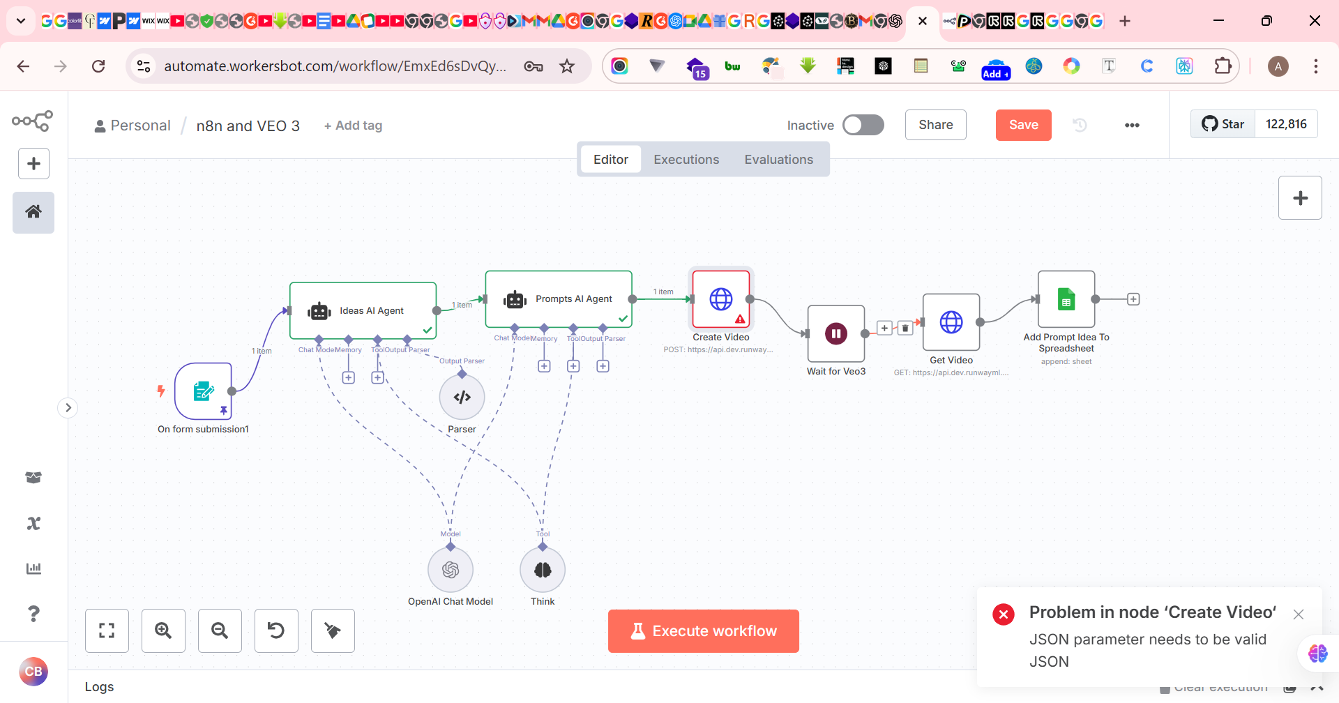

Hello cutecatcode i still run into some issue , i just added credit to my runway dev account , as i tried to use it instead of vo3 , but i still run into same issue , i used the body jason from runway
but this is what i kept getting
and this is my workflow
I think you miss-configured the json, can you show us your json here?

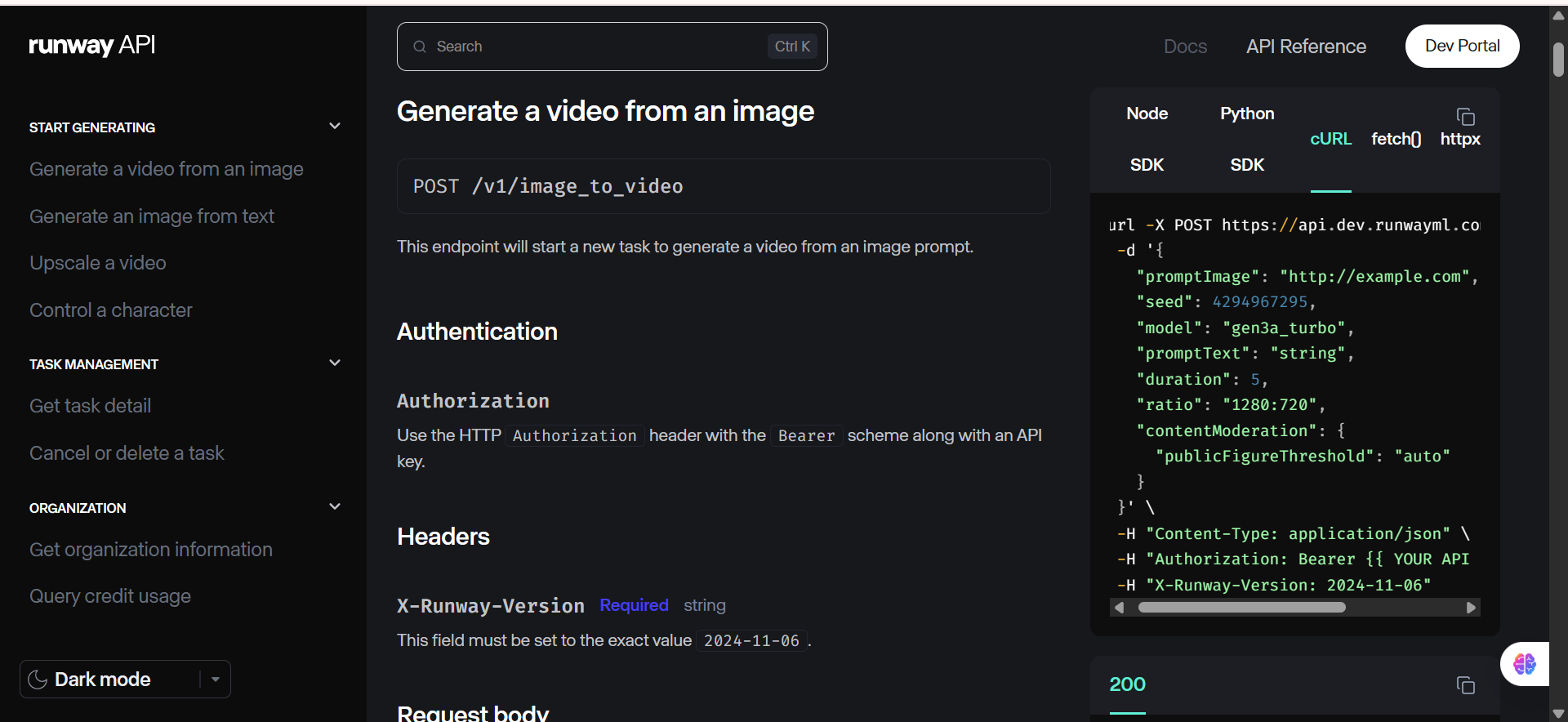

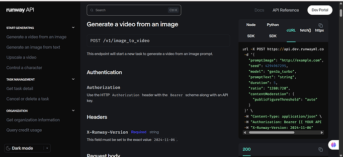

yes
“promptImage”: “https://encrypted-tbn3.gstatic.com”,
“seed”: 4294967295,
“model”: “gen3a_turbo”,
“promptText”: “string”,
“duration”: 10,
“ratio”: “1280:720”,
“contentModeration”: {
“publicFigureThreshold”: “auto”
It’s weird since the JSON is correct.
What about fal.ai documentation?
