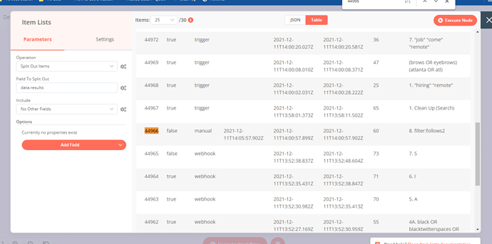

But it seems I have another issue now. I added to the flow “1. Clean Up (Search)” but as you can see in the screenshot, it triggered even though 2 other flows were already running.
The example you have shared would only check if the current workflow is already executing more than once, if I see that correctly.
Based on your screenshot I understand however you want to check whether any other workflow is running? If so, you wouldn’t need to filter for the current workflow ID. You could just check whether there are more than 1 workflows running in total. Simply remove the filter part .filter(execution => execution.workflowId.toString() === $workflow.id.toString()) from your Function.
Awesome. Thanks for the quick response. That worked!
