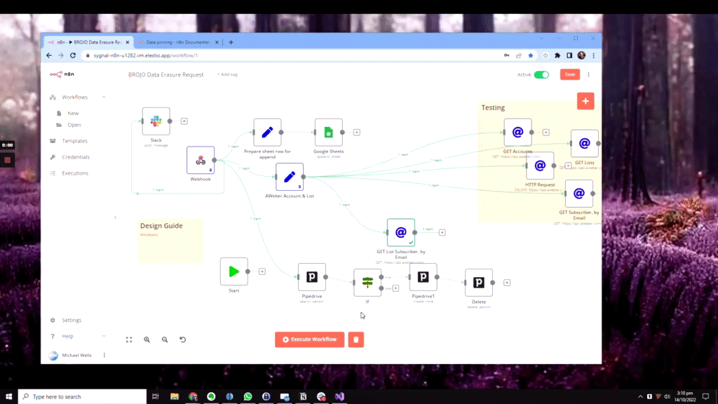

I’ve made good progress, figured out what AWeber needed for its auth setup, and how to access that from n8n. I’m now able to make basic calls successfully. However I seem to be doing something incorrectly when an endpoint has a querystring. I can see my source data, and my expression computing as expected- but that’s not what is getting passed to the API.
Better to show with a Loom vid;
Update, I’ve narrowed this down a bit further, the problem seems to relate to editing pinned data. I’ll start a separate post about that, as i’ve worked out the AWeber integration. Thanks!
