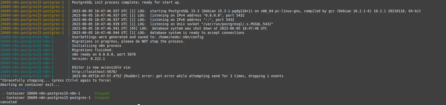

Hi @Serban_Teodorescu, welcome to the community.
I am sorry to hear you’re having trouble. I quickly gave the below docker compose set up a go, but could start n8n just fine against PostgreSQL v15:

There were no db-related errors:
