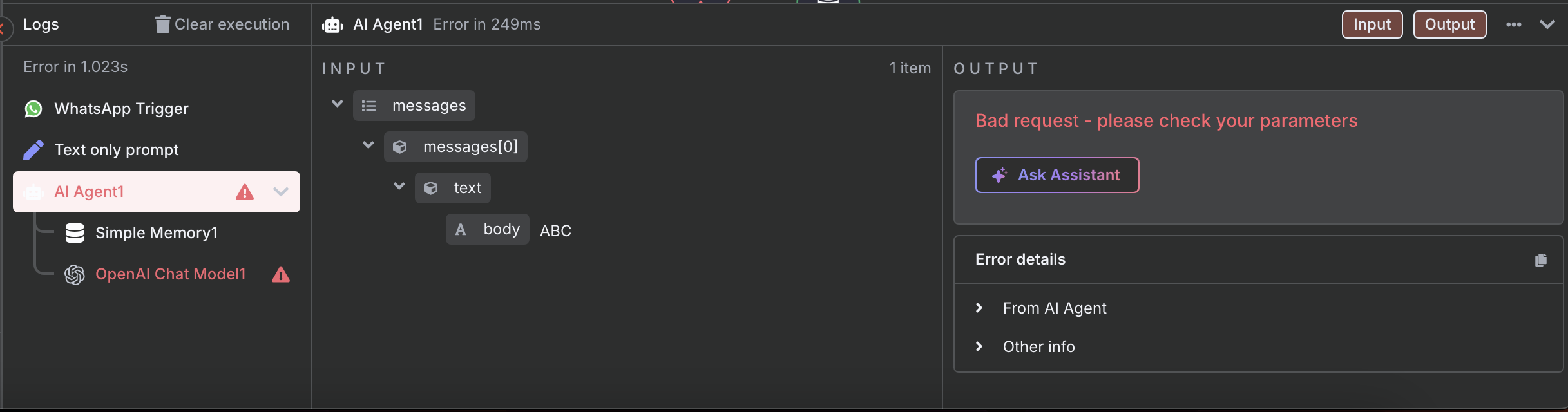

Before linking my memory node, the workflow can run successfully. After linking there is an error saying: ‘Bad request - please check parameter, Invalid value for ‘content’: expected a string, got null.’ Error is on both the ai agent model and open ai chat model. How can I fix this?

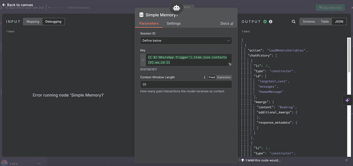

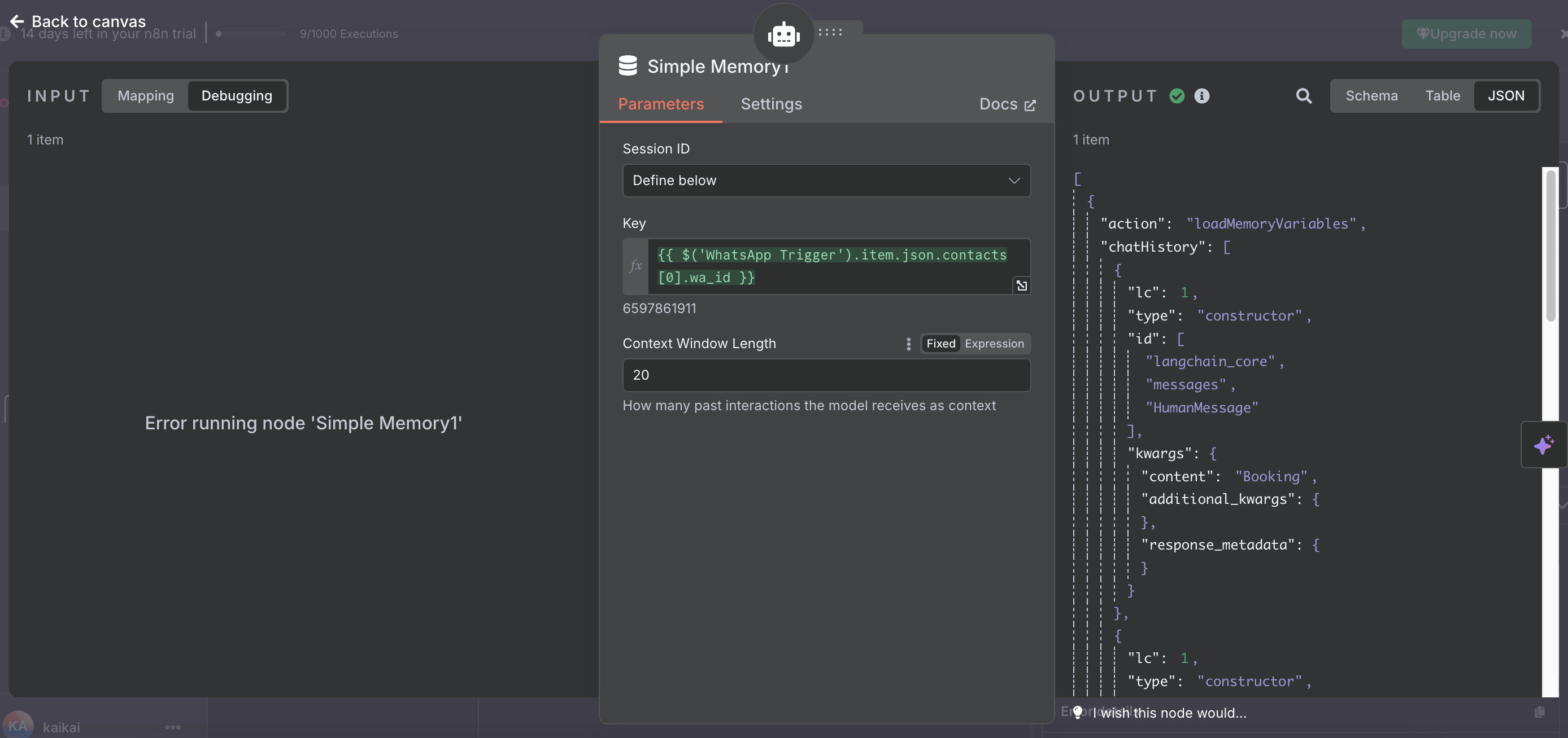

it is currently taking from the trigger, with the wa_id (phone number) as the key. I have recreated the node, but it still does not work

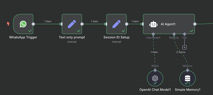

I wanted to build by work flow to process text prompt only but using ‘edit field (set)’ node.
whatapp cloud trigger
edit field (set) → manual mapping {{ $json.messages[0].text.body }}
ai agent
simple memory → {{ $(‘WhatsApp Trigger’).item.json.contacts[0].wa_id }}
open ai chat model

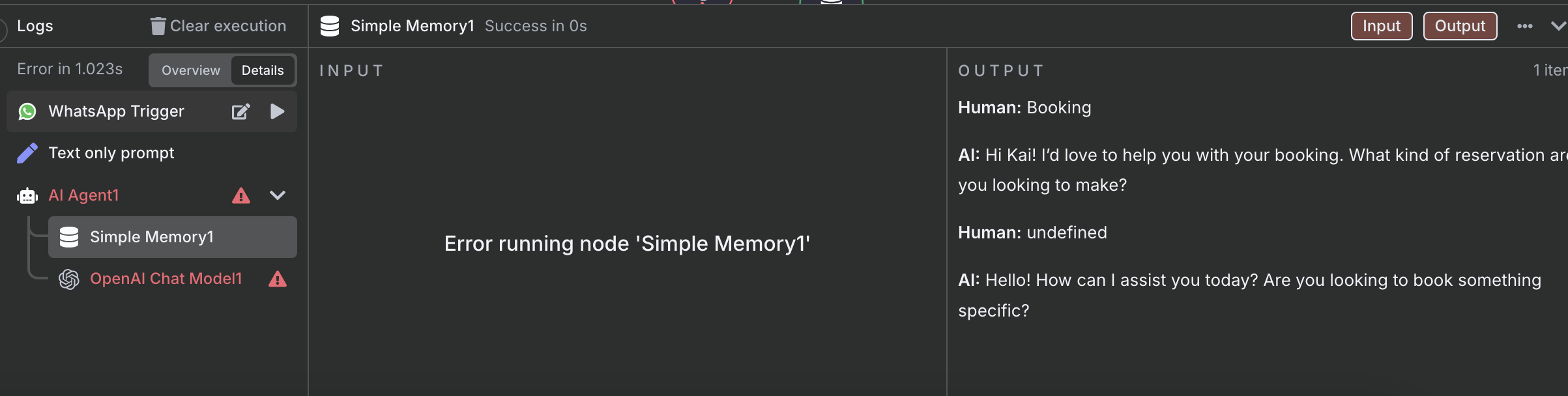

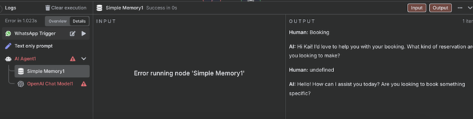

I’m guessing during my test, when I trigger whatsapp prompt with an image upload, it may have affected simple memory. So when I tried sending text again, it did not work
After adding a session ID setup, it worked. Also tested with triggering:
text → worked
image → did not work
text → worked
But I’m not sure why adding session ID setup worked
