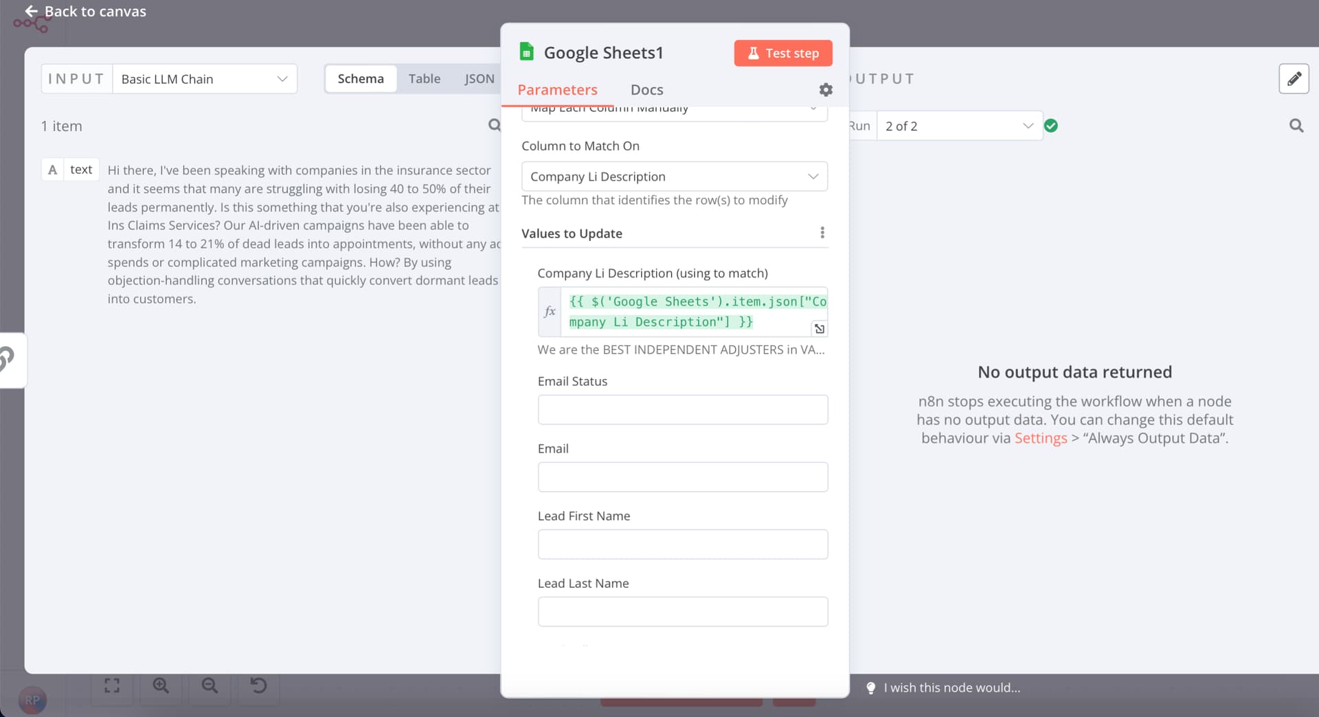

There was an issue with openAI which I have resolved but couldnt able to solve the main purpose of updating a row in a sheet with customised email in a particular row via OpenAI.Please check the screenshot and advice. Even though I have entered correct input field.Also when I open the google sheet1 couldnt able to see any updates in intended row. Kindly advice.
hi @Naved_Shaikh
a few suggestions:
  1. In this case you don’t need to use the Loop Over Items. n8n will iterate automatically on each item.
  2. In Google Sheets1 node, I recommend using a field like company name, company domain, or company ID to match the update (parameter: Column to Match On). This is used to recognize the row to update in the sheet.
  3. Then in Google Sheets1 node you need to map the data coming from OpenAI to another parameter ((in Values to Update) that corresponds to the sheet column you want to fill
  4. Looking at your use case, you could probably use the Open AI node
I attach you a demo workflow you can look at:
I hope it helps!
