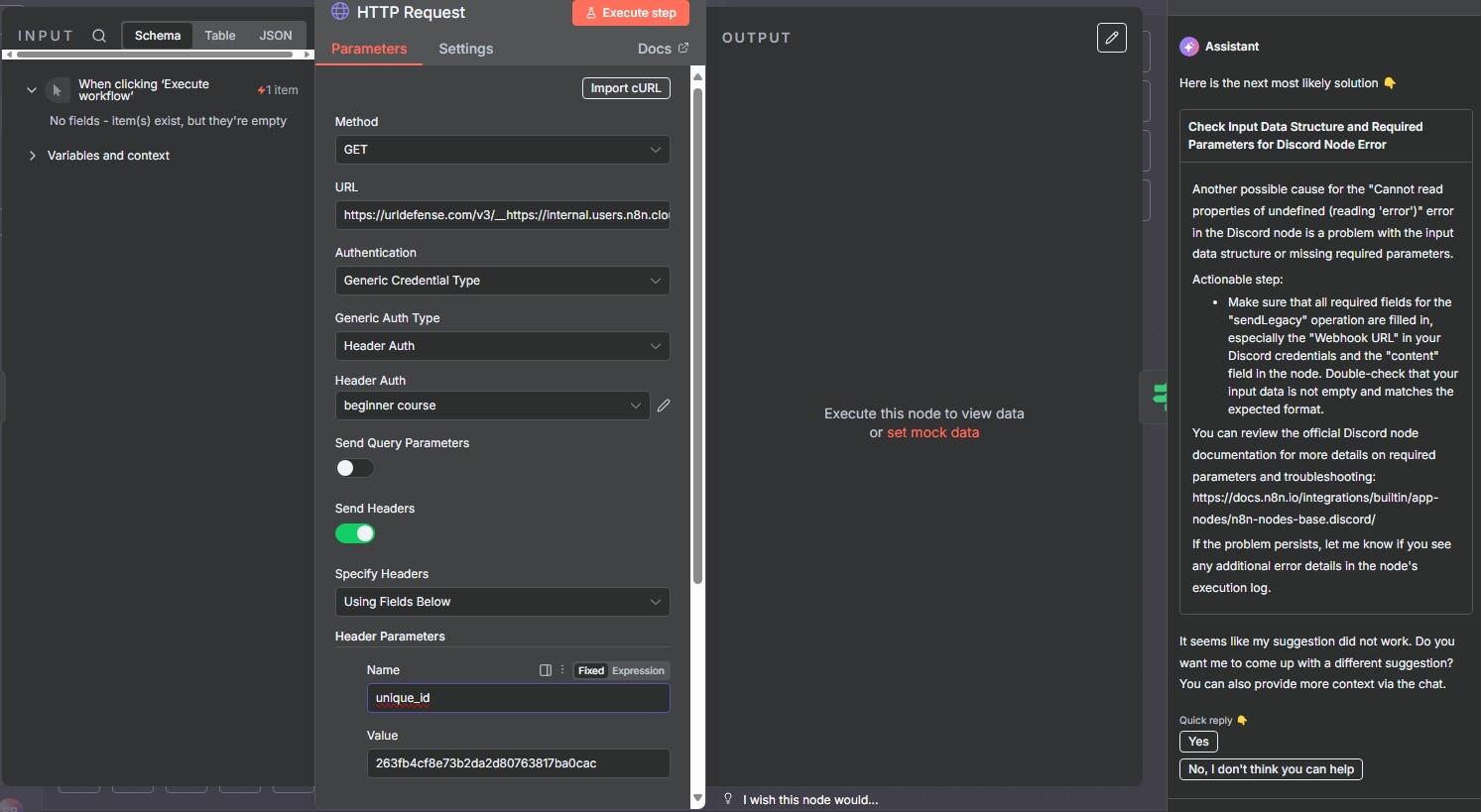

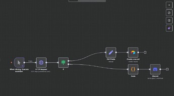

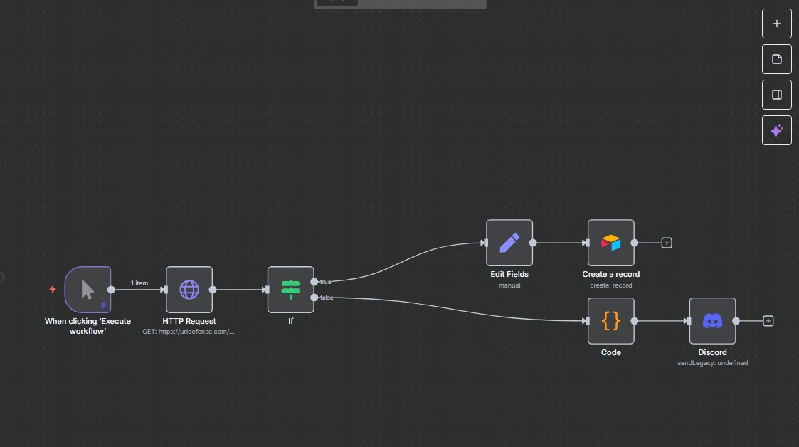

Help…I am new to n8n and have started the beginner course to learn more about automation and ai. I am on the Notifying the Team part where I need to connect the “discord” node to the “code” node. I’ve backed tracked and have been reading through previous forums to see wheat I might have missed and feel like I’ve tried everything lol and nothing seems to work.
If you have any recommendations or have taken the course and experienced the same brick wall, please comment. I have been stuck all day. Here are some photos to hopefully help with what I’m dealing with.

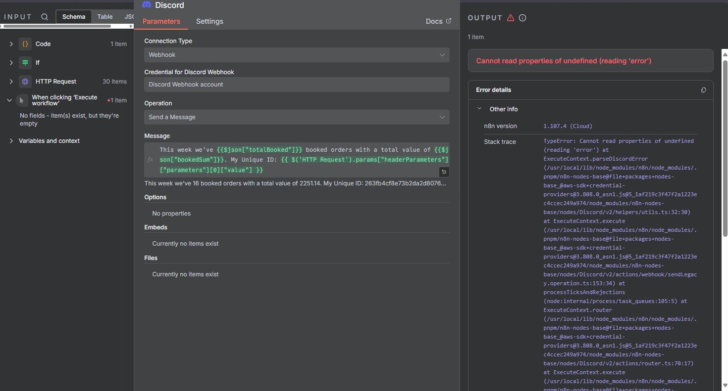

Can you show the error you get in a better way?
Does this help at all? Its bugging me that I can’t figure it out yet lmao. But thanks for responding!
Was the connection successful?
You can try creating another Discord webhook URL and using a new node. Unfortunately, the Discord error message doesn’t say much.
Everything connects successfully except the discord application. I will try your idea next. Sounds like it’ll resolve something in the mean time. Thanks.
Screenshot_22-8-2025_16128_discord.com
I did what you recommended, and it worked! I think the issue might be with the link the course gives you doesnt work
These links usually expire or may have been deleted if it is old.
