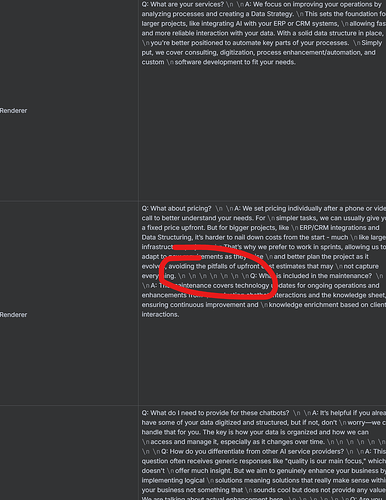

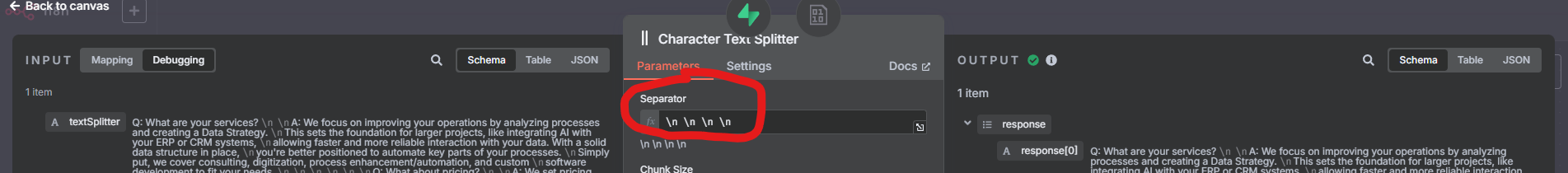

I organized my simple Q and A document in a way that it has multiple line breaks in between new questions and answers. I just simply would like to know what the best way of embedding q and a documents is. I used the default data loader and the recursive text splitter as you can see and wanted to enter the line breaks as seperator but it didnt seem to work. Any help would be highly appreciated :slight_smile:

Hello there!
I see that you’re trying to split the text by 2 newlines, but since a newline is a special “escape character”, you need to do it as an expression using JavaScript code. So, in your case you can try using the following expression in the “Separator” field: {{ " \n \n" }}. This way the newlines are treated properly and not just as regular text. Also make sure to properly configure the “Chuck Size”, which controls the max number of characters in a chunk, before the text splitter actually splits it
Hope this helps!
It now split it into 3 chunks but still did not trigger on some of them
this is what I entered so I dont quite get it.
What is your “Chunk Size”? If it’s set to be a large number, the text splitter might not split the text, even if it has the separator, so try decreasing the chunk size
Well but isnt that the point. The chunk should be the max. And the seperator should seperate before that. Cause otherwise I could very well just use chunk size and make it way smaller.
I had some time to test and actually can confirm that the size does matter (a phrase I didn’t think I’d say). If the chunk size is relatively small (smaller than the text I am trying to split, it starts using splitter.
