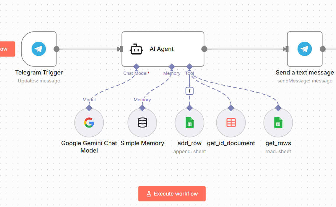

I’m building an AI agent that interacts with some Google Sheets tables and I don’t know whether the attributes those tools require should be left as “defined automatically by the model” or if I should ask the model to send a well-structured JSON to the tool and keep the attributes explicitly defined?
I want to know which option might be best or if it doesn’t matter (or if there are any best practices to stop the model from getting confused about what it should send to the tools).
