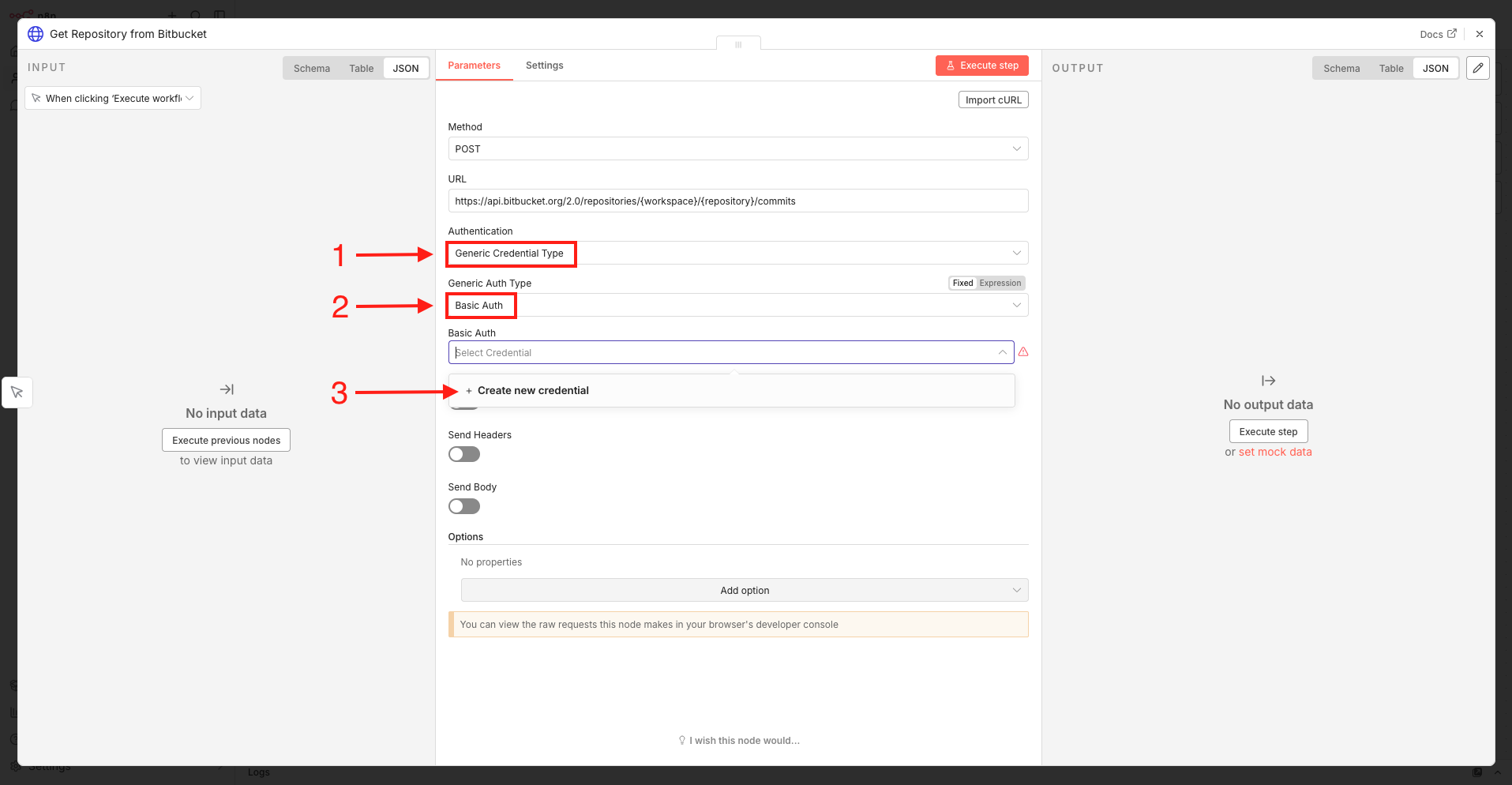

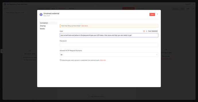

@b_rom Hey, I think you need to configure the http node properly, please check the below images of how to do so:
