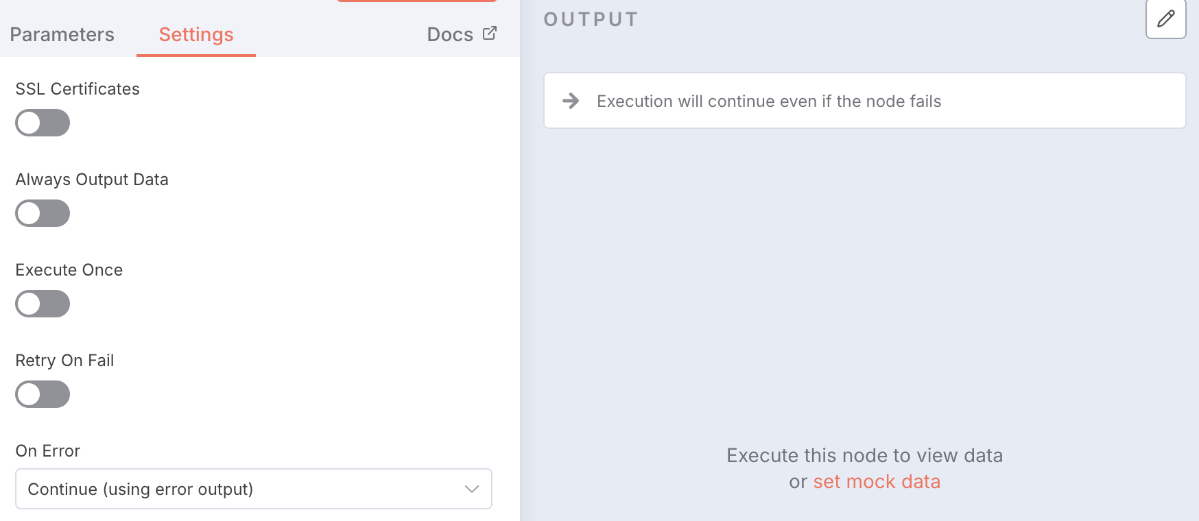

Hello! I’ve been using the “Continue (using error output)” option on nodes but just recently realized that if I don’t put a stop and error node on the error output it will keep executing my flow with broken data. I want to avoid this. My initial thinking was the feature branched to a new error path and stopped the normal path so I can handle each error individually without it messing up the rest of my flow. Is there anyway to do this? Ideally this is fixed with a stop node but there’s only stop and error which causes my error workflow to run which I don’t want in specific error cases (ie I want to stop the flow without error but it continues instead).

This doesn’t seem to be the case. In the latest update when setting “Continue (using error output)” the node UI even says it will continue in case of fail.

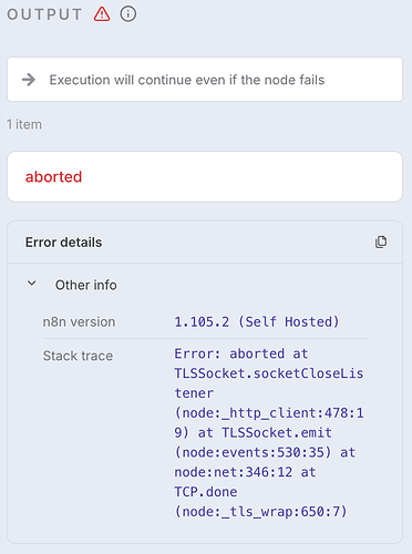

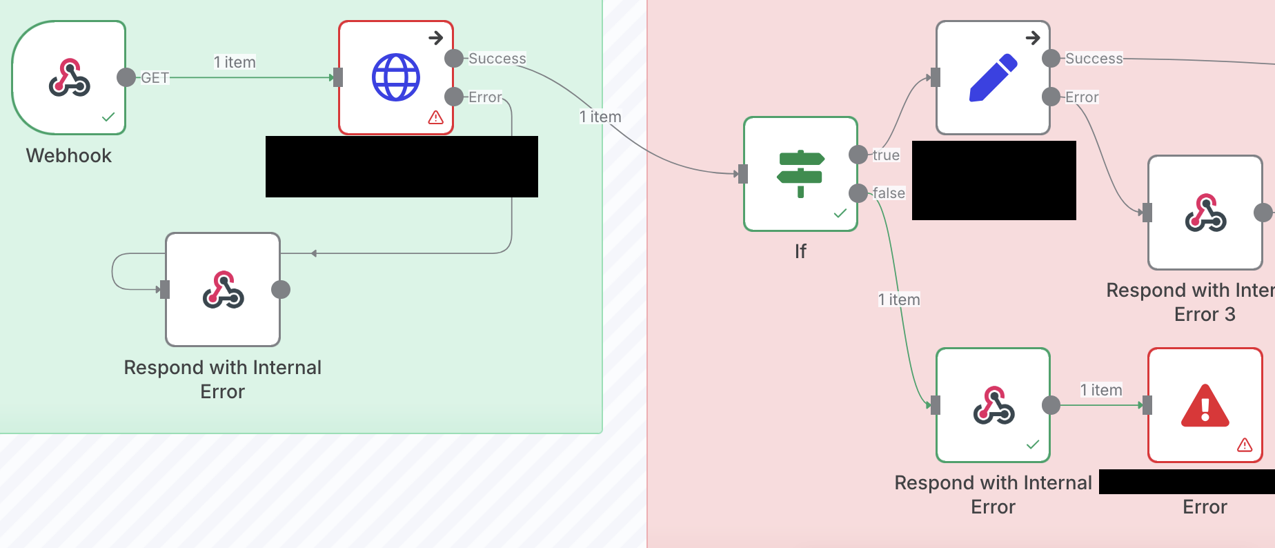

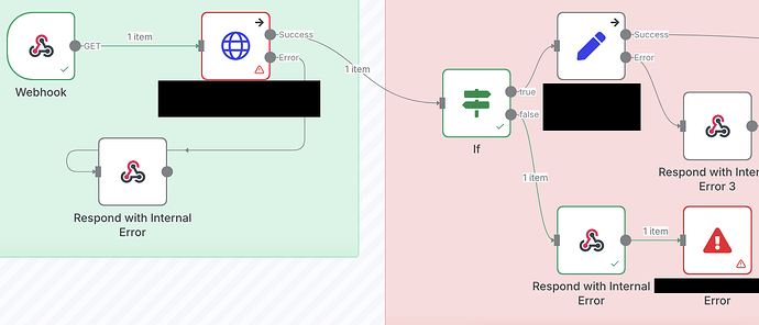

I do not want execution to continue on the success branch (which it indeed does). See a below screenshot of an example run I did - notice the HTTP Request Node errored but the If node connected to it was still run (with empty data causing it to break).
Maybe this is a bug? Here was the error from the HTTP Node

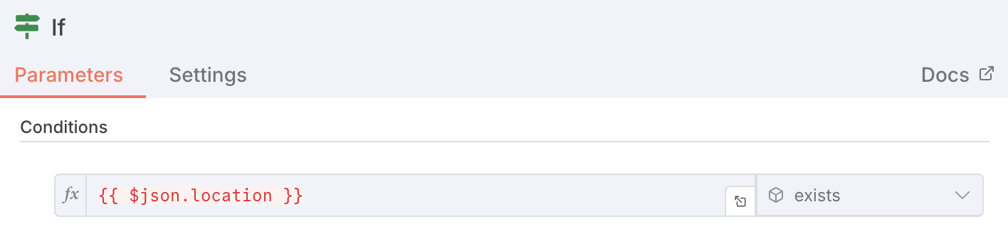

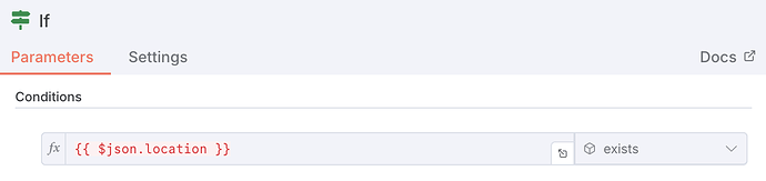

Then the If node ran and received nothing (causing an error)
